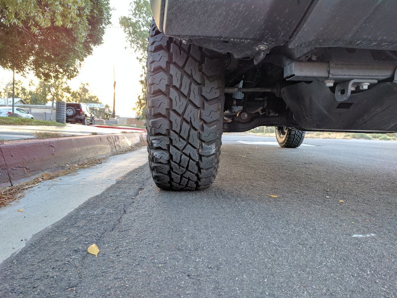

    Is this good enough? Or do I need to have the chalk completely gone? Is there a standard to how much PSI to add for every 100 lb. of load?IMG_20170513_060136.jpg

    I'd go farther. You're doing right by deflating down.
    Chalk is nice but makes no allowance for a laden vehicle or dynamic loading of the tire.
    I recommend adding 10% to whatever your final chalk PSI is.
    There is no standard for PSI-to-weight. But, it can be calculated if we know your tire size and load rating.

    You're right. I actually had to add air last night 'cause I needed to haul 10 crates full of books and a big cooler full of frozen meat.
    The front PSI is 34 at that "chalk level". When it was at 33, the chalked was rubbed off from about 98% of the whole surface (width).
    My tires are: Cooper Discoverer ST Maxx 265/75/16 Load E.
    The calculation you mentioned is intriguing, I'm looking forward to seeing it.

    A 265/75/16/E has a 1,910 lb load rating @ 35 psi; and 2,100 lbs @ 40 psi.
    2,100-1,910=190 lbs
    40-35=5 psi
    190 lbs/5 psi=38 lbs/1 psi

    I'm curious...
    • Where did 1,910 lb at 35 psi come from?
    • Where did 2,100 lb at 40 psi come from?
    • I'm assuming this formula is what I use to determine how much air to add after a chalk test (with the whole width of chalk marks erased) prior to adding load.
    • 38 lb/1 psi is per tire, right?
      • If I have a 200 lb passenger, I would add 1.32 psi per tire, correct?

    Toyo load inflation pdf.
    https://toyotires-1524598101.netdna...ication_of_load_inflation_tables_20170203.pdf
    Correct; per tire...

    Thanks for the resource. I wonder how accurate the chalk test would be in relation to this calculation. Too bad I don't have hundreds of pounds worth of load laying around to test this out.
    If I applied your recommendation, won't the chalk marks then be thicker at the edges leaving me with bald center tread in the long run?
    I'm assuming this recommendation is for when I need to load something heavy and not bother about worrying whether or not my tires are sufficiently inflated.

    Correct; payload purposes.
    It's optional.
    I haul heavy loads on a regular enough basis; I don't want to mess with it all the time. Today it was 800 lbs of wire...
