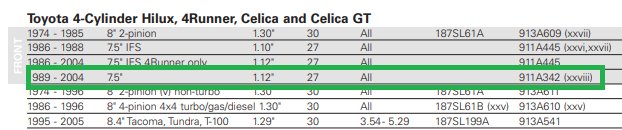

    So I have a 2002 5 lug with the 7.5" rear and want to get a True Trac to get some real traction going. I was looking through the True Trac catalog and only see one listed for the front, can anyone confirm if this will fit in the rear by chance?
    I had a "gear specialist" tell me it will, but I would like to double check before ordering up the parts!

    I was able to have my local gear specialist install the TrueTrac as mentioned above yesterday. Recall this was part #911A342, it actually had a part #911A644 printed on the diff itself when I pulled it from the box!
    He stated it was set up with proper rotation to use in the rear so didnt need to flip anything. Also mentioned all the parts I purchased worked out for the installation. This was basically all oem stock parts used for the full rebuild with the exception of running the "larger 50mm" diff carrier bearings. Here was the parts list used:
