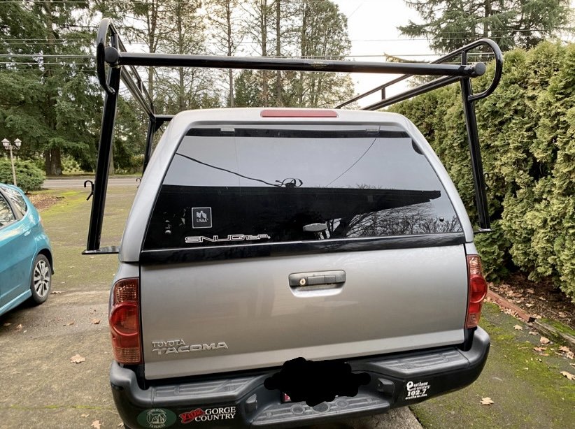

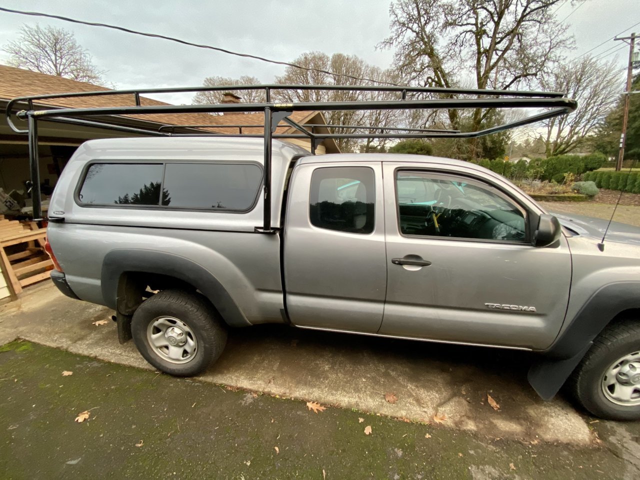

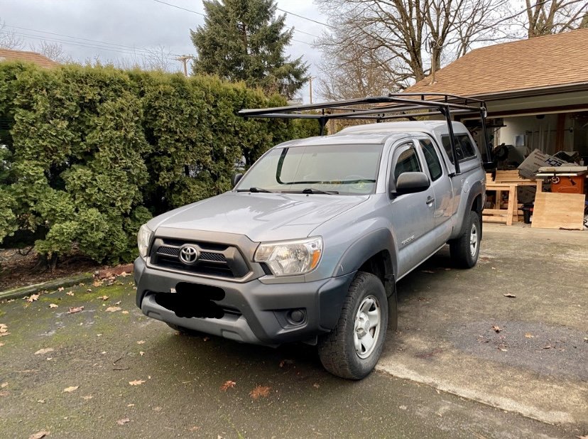

    Hadn’t seen a set up like this. I’m either crazy or a genius... or a crazy genius! Next up is drawers in the bed that I can sleep on top ofBA2F65D9-FA23-4FC6-AA27-1B21638A1505.jpg

    that looks nice but man that's alot of leverage on those bed rails which the tacoma bed is already known to be not the strongest to begin with. Have any pictures of how it mounts and secures inside the cap?

    Is that rack made to fit a tacoma? Seems oversized. Most I've seen rests on the top bed rails and doesn't extend width or even the length like this one.

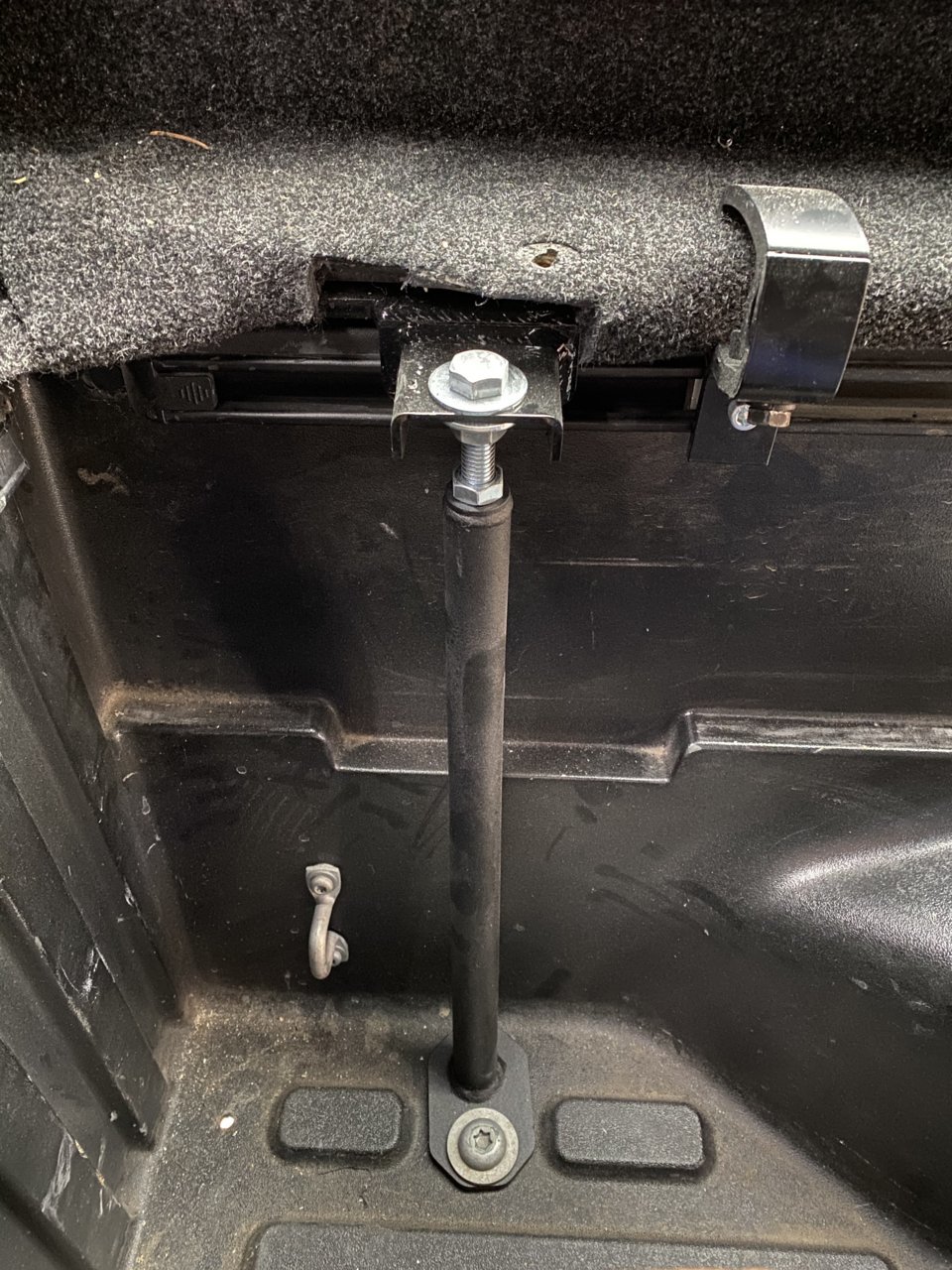

    Yes it’s specifically designed for the Tacoma it’s a Rack it 3000. Here’s where it connects to the bed1055A0CB-CFD4-4ED6-9328-26ED88E1C99B.jpg6C947E02-8368-4E7E-8F7F-073703D9ECB1.jpg 1055A0CB-CFD4-4ED6-9328-26ED88E1C99B.jpg
    It drills into the only steel in the bed by the tailgate. By the cab a steel arm goes down and is connected to the bolt that goes through the bed to the frame. So it’s supported on steel, not the composite bed sides

    I have seen similar. Maybe look into a bed stiffener

    I’d like to do that but I don’t think any stiffeners would fit with the rear rack support. They’re in the same place

    yeah, I think you’re right, stiffeners will interfere

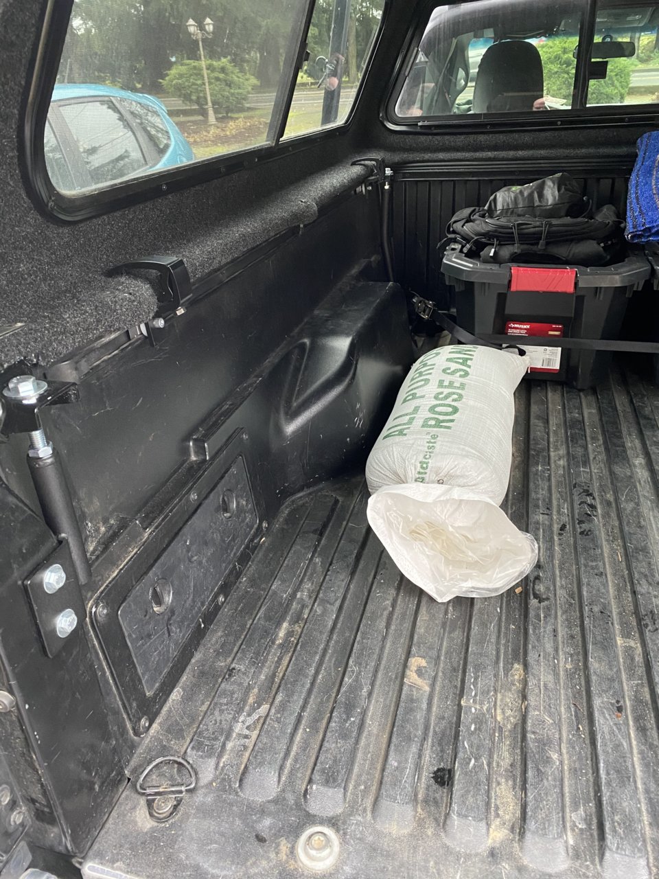

    Right on! For some reason my just started to bounce. I am wondering if it is because I took off the clamps and bolted the camper shell down. Might have to re-clamp it along with the bolts on it. IMG_1180.jpg

    Yeah you need to use the clamps that came with the rack

    Only problem with those RackIt racks pictured is they're floating way too high above the topper/cab. Looks like they're levitating.
    I have a KargoMastger III rack (with a utility cap on back) that hugs the roof much closer, about 1/2" to the top of the (high-profile) rear cap, about 6-7" to the top of the cab.
