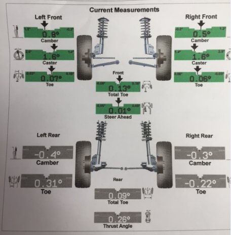

    So at my wits end with trying to get my 2011 DCSB to track somewhat straight down the road. Truck constantly pulls to the left and after removing all 4 of the Cam bolts in lower control arms and putting anti-seize on all four cam bolts, putting in new control arm bushings, new lower ball joints, and put on four new 285/65/R18 Nitto Trail Grapplers with balance and alignment yesterday the truck still pulls to the left quite hard. Anyone having a similar issue or any other ideas on what could still be causing this issue?
    Specs from my alignment yesterday:

    try to make the caster angle 1 degree or 1and 1/2 degrees higher on the right side

    Take a look at the rear suspension setup, you have some positive thrust angle, which I think drives it to the left? Axle could be rotated from the lift maybe

    Thanks for the replies, much appreciated. Going to go back in for another alignment next week and see if they can find or fix the issue. Keeping my fingers crossed that it was just mis-aligned but since this issue was going on before the new tires I'm not holding my breath. Going to ask them to get me as close to 0* Camber, 0* Toe and 2.5* Caster as possible. If issue persists guess I'm back to the drawing board and will try flipping the tires around and then possibly thrust angle or rear bearing.
