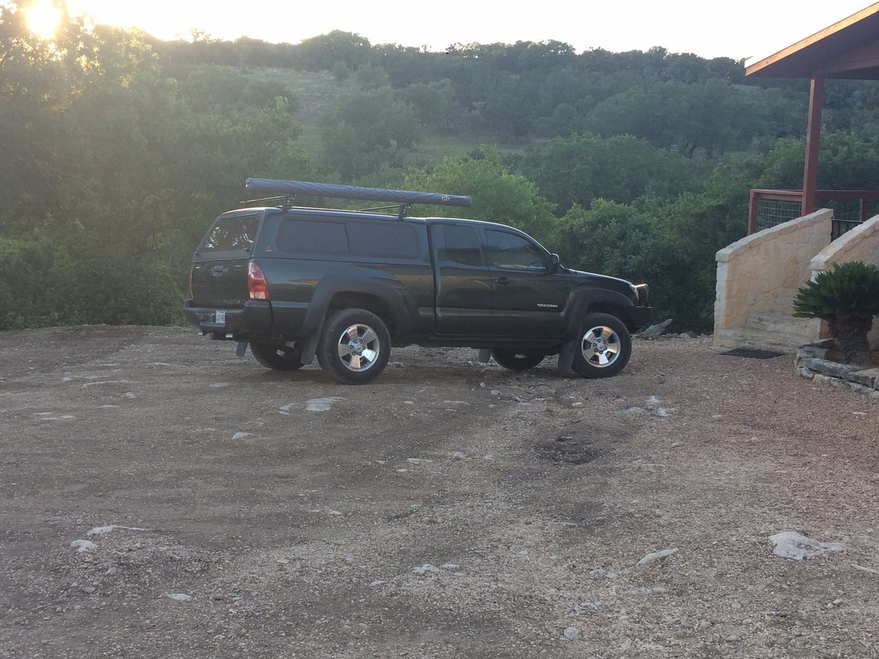

    I had a set on mine for about a week, so there wont be any fitment issues, youre good to go there. As far as the larger tire, you may notice a very slight loss in power but its pretty much negligible imo. Ive got 265/70/17s on it now with fj wheels and added a bunch of weight and ive pretty much made up my mind to upsize to 285s now on stock gears. If you have a 5spd you wont even notice the difference in power. That may be a different story if you have the 4spd auto, but my dad has 265/75/16s on his 4 banger 4spd auto and he doesnt have any problems with it. He also has an ARB bumper

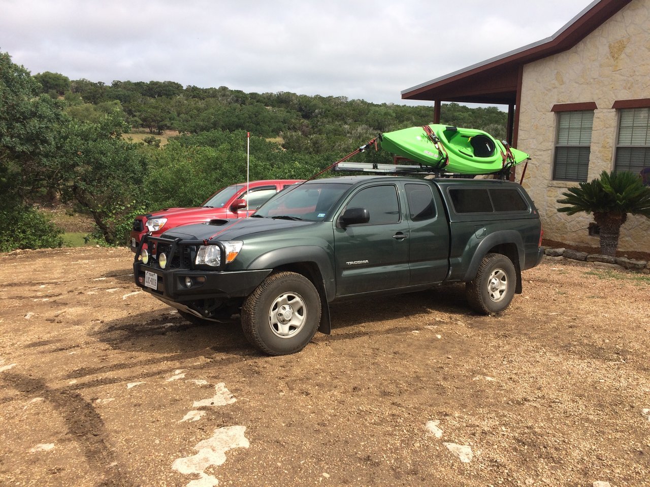

    I dont think you have anything to worry about on performance losses if you go with a 265/65/17 and stick to a p rated or c rated tire. I ran 265/75/16s (which is the same size as a 265/70/17) in load range e for a while, and it turned them no problem with a very minimal loss in power. With the lighter wheels like you mentioned and not a load range e tire, you should be fine
    Heres a pic of the load range e’s i had on stock steelies. That was a really heavy wheel/tire combo, but the truck still did fine.
    Let me know if you have any questions, im happy to help
