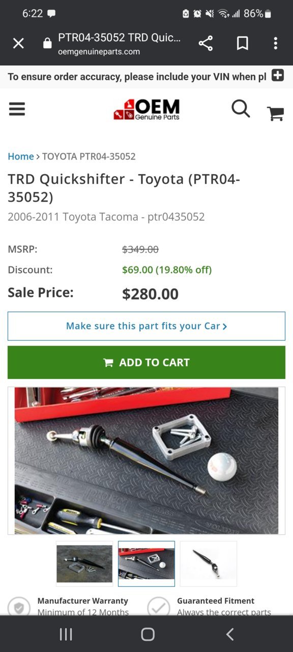

    Sorry to revive an old thread, but what's the part number for the 4x4 short throw shifter?
    This is the only one I can find

    Yep, that's it. Same part number I used for mine. Bought from McGeorge Toyota for $274 a couple years ago.

    Interesting, this one says it's for an x runner

    Got me. tbh, I didn't even know there were different part #s for xrunner and 4x4.

    They were talking about it in the thread a bit. But if it works for your 4x4 it's probably fine
