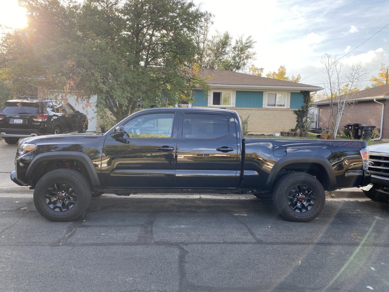

    Follow up:
    The shocks I’d found were on Craigslist listed for $1300. I offered the guy $1k and he accepted. I threw them on yesterday (nice to have a friend with a lift).
    They leveled the truck perfectly. I’m just saying this from my visual impression. I took no measurements because I don’t care.
    Today I took the truck on a little loop of some twisty roads, both paved and washboard dirt. This is my favorite kind of driving and the truck did great! Noticeable improvement. I had way less body roll, feeling much better on paved twisties. Even better was the composure over the washboards.
    Definite, noticeable upgrade. I feel like it was money well spent. I also like the bit of red peeking out as my truck has a black with a little red theme.
