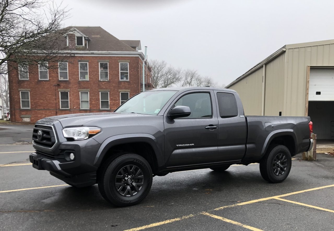

    Everything there sounds good but before shipping them to FOX I just wanted to double check and be sure I won't have any issues mounting these to a 2020 SR5 Access Cab 4x4 V6? From what I have read on TW all 3rd Gen suspension is interchangeable and these should bolt right up to my SR5. However I am unsure if there are any additional components needed to complete the swap? Any guidance if the Trd Pro UCA, leaf pack, sway bar etc are required would be helpful. It looks like the Trd Pro parking brake cable spacer (PTR61-35201-PK) might be a must have but again not entirely sure.
    Also, what type of lift would these accomplish on a SR5 AC? Lastly, would it be prudent to swap out the needle bearing for the ECGS replacement even though FOX suspension would provide an OEM lift?
    Thanks in advance and I appreciate any advice people have to share.
    Pics of the suspension after I picked them up. The coating on the coils has cracked and chipped away causing some rust, definitely going to replace. Other then that they are dirty but seem to be in good shape.
    SR5 in question...

    You will have zero issue mounting these onto your truck. Send them to Fox, get them overhauled, install and enjoy!
    The front will lift 1" over your stock suspension. The rear will remain the same.
    The Pro comes factory with the needle bearing And have no issues. For me, I installed the bushing for peice of mine and so I didn't have to go back in if issues arouse. That is a personal call...

    Yes. The Pro's have the same leaf springs as the other models so installing the Pro suspension on the truck will raise the front but shocks won't lift the rear so the ride height won't change.

    Since those are 2017-2019 pro suspension, you dont need or want the rear block. The spacer part for the brake line was not needed on my truck, but its also vin locked by the dealer, so it might be hard to get from them.
    Those will bolt right on to your truck, no changes need to be done. They will lift the front 1 inch and nothing in the rear, but the truck will sit level (non-pro trucks have a 1 inch higher rear than front)
