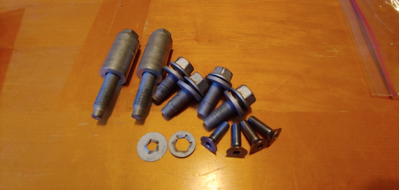

    I also bought a set of these just for the back two, if someone needs the other parts I can sell.

    What would you take for the 4 access panel screws?
