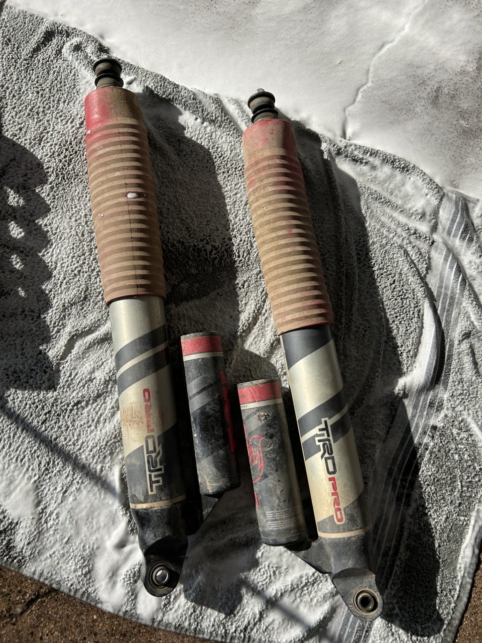

    Just picked up a set up OEM TRD Pro fox suspension off a 2021 with 19k miles. Do I need to get different UCA’s or any other components to make these fit?

    Don’t think you need the UCA’s
    But all other stuff will fit

    I just installed these on my truck 4 weeks ago or something.
    Those parts will fit on 2nd Gen.
    see attached.
    Just keep in mind that the spring rate is #700 lbs from what I have researched.
    If you have a spacer lift of more than 1/2in the stock UCA will rub on the spring at maximum droop. You can see the light rust spot.
    I run this issue of a setup, but… I’m a cheapskate and I don’t wheel that hard.
    I don’t hear anything when it rubs, so meh. A problem for a future blueberry… fuck that guy.
    You WILL run into an issue where the LCA shock tab is bent inwards. Just bend it outwards just a bit with love kisses from the sledge or similar, and you are good to go.
    Happy trailblazing!

    Note below is subjective.
    Installed Recall leaf springs, replaced old Off-road yellow shocks.
    TLDR:
    1.8 in of lift from coil overs.
    Improved ride quality from stock.
    15% Reduction of breaks dive.
    Good off-road.
    Great on-road
    Kinda stiff but manageable.
    8/10 would recommend if you are on a budget and looking for a simple bolt on replacement, that’s is a 15-20% improvement from stock.
    Ride Quality 7/10
    • Great on road. I don’t notice too much my poorly maintained pavements. Not perfect like a Rolls but great.
    • Good on washboards
    • 15% less on the break dive (noticeable and very nice)
    • Good on bumps at speed or crawling.
    • Kinda stiff with 700lbs spring rate.
    • Better than stock, but I had a budget. It’s not perfect, but hey better than stock.
    Lift height?
    That’s a complicated question. I had to dig into so many rabbit holes and dead ends researching this very question.
    Here is the TLDR.
    With these on a 2nd Gen you gain a total of 1.8in approx of height (measured from hub to fender).
    A) With the factory equipped 1in lift for 3rd Gen.
    B) Plus the higher LBS spring rate for a 3rd Gen, if installed on a 2nd Gen you gain 0.5-0.8in (approx)
    (0.8 if no winch or heavy bumper.
    0.5 if installed winch or heavy bumper. This math will change if you have a 4cyl vs the 6cyl. I have the 6cyl)
    C) 1/4 or 1/2 spacer can be installed w/o issue if you want. Any more you will run into issues.
    UCA and coil contact at full droop.
    LCA maxed out at maximum droop.
    Potential CV bind
    A+B+C= lift maths.
    Full Droop = where all installed components are at the lowest possible angle possible.
    Maximum Droop = where the LCA itself is at the lowest maximum angle possible.
    Does the truck sit well?
    Yeah looks good to me see the photos, I did have to raise the rear with a 1.5” block for now. Your mileage may vary.
    (yes yes I know spacer block bad!)
    Until I save up for a AAL or Leaf pack I haven’t decided the block stays, and the Recall leafs are new. 3 months old.
    Oh hey I found a photo of the UCA rub.
