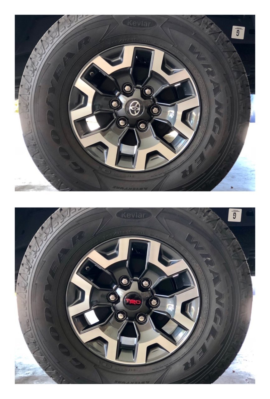

    2018 Stock 16" TRD OR wheels: IMG_9617.jpg

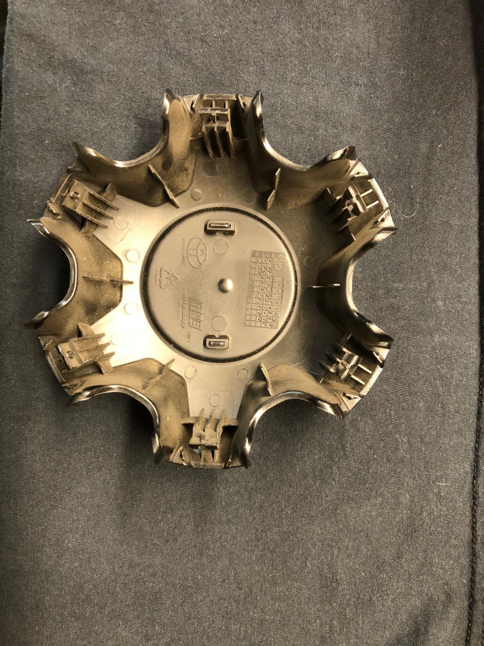

    The center cap just pulls off. It's held on by 5 plastic tabs. No need to remove lug nuts.
    Back Side: IMG_9620.jpg Toyota emblem: IMG_9621.jpg
    The emblem is easily removed. Just a good smack with a small hammer to the tabs that protrude through the center cap. Then pull or pry it off the front. The tips of my tabs were not melted, just a little thicker than the slot they fit through.
    Hope someone finds this information helpful.
    IMG_9619.jpg :)
