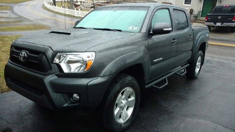

    I bought a 2015 DCSB on looks alone, love it. Don't really know what Bilstein suspension is, or the handling difference with 17" tires, but I'm satisfied. I put a tonneau cover and some predator style step bars on, and weathertech fitted floor mats. Next up is weathertech bug/wind deflectors.Looking at some rims and more aggressive tires, maybe a better stereo and speakers in the next year or so.
    I don't do any off roading, except for the occasional farmer's field or steep mountain dirt road, this truck does fine. Any advice on rims/tires/stereo is much appreciated!

    Nice truck. As far as tires I have the hankook dynapro all terrain tires. Not a bad ride coming from stock street tires but I know a lot of people ride bfg ko2. As far as rims I've been looking into stealth series ray10. That's just me. Depends on ur taste. As far as stereo. If you have the money I would personally go alpine double din. JL subwoofer with a marvelous marv built box.
