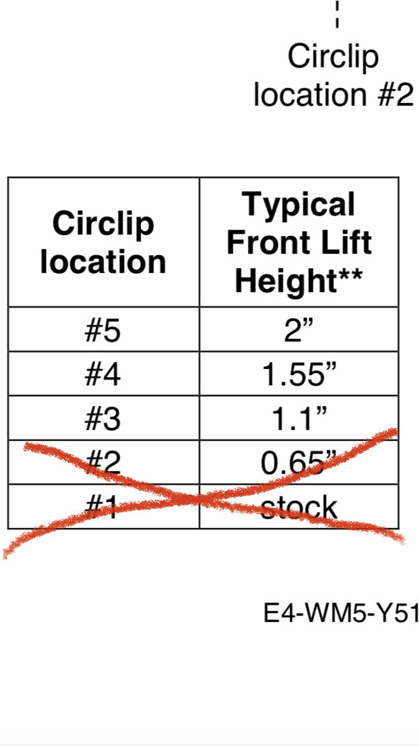

    Any springs that will fit stock struts, or 5100’s will fit the TRD lift struts. Just remember if you get lift springs, the TRD bilstiens are missing the lowest two notches. So assuming they didn’t change distances between the top three notches, you have 2in., 1.55in., and a 1.1in. lift setting on the TRD 5100. I think when I upgrade my suspension, I’m going with just the shocks from the TRD lift kit, set on the lowest setting with 1in. Dobinsons lift springs in the front, and a 1.5in HS AAL in the rear.
