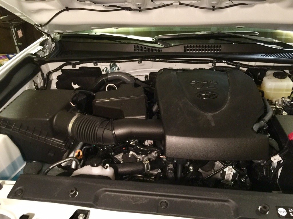

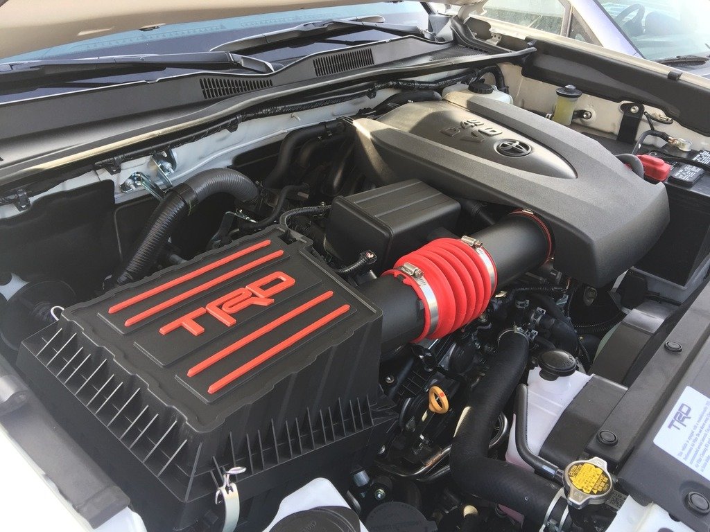

    Ok, now that we're done with that, here's my review of the TRD Intake for the 2016+ Tacoma's. This was installed on my 2017 M/T Trd Pro.

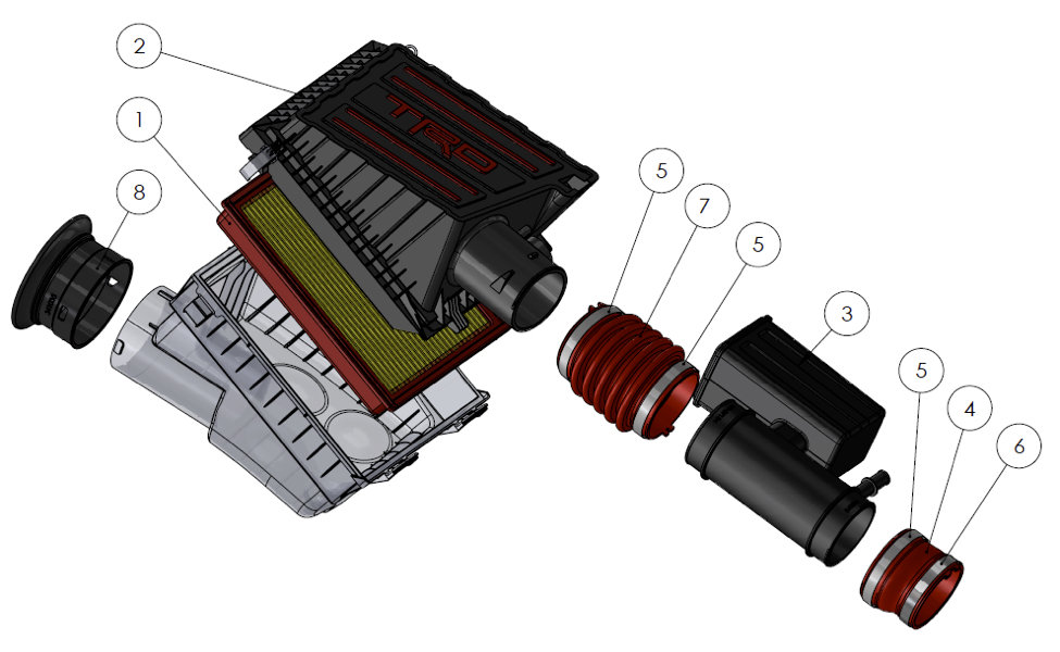

    Kit Part #: PTR03-35160
    Diagram:
    Parts List:
    1: PTR03-34140 (TRD Panel Air Filter)
    2: PTR03-35160-AA (Upper Airbox)
    3: PTR03-35160-AB (Intake Tube) & PTR03-35160-AC (Throttle Body Coupler Kit)
    4: 341032 (Coupler)
    5: #52 (Hose Clamp)
    6: #48 (Hose Clamp) & PTR03-35160-AD (Airbox Bellows Kit)
    7: 341033 (Bellows)
    8: PTR03-35160-AE (Intake Flow Accelerator/Horn)

    Before
    After

    Installation of this intake was a breeze. The instructions from TRD USA are very thorough and lay everything out for you (bottom of this page: http://www.trdusa.com/parts-detail.html?p=PTR03-35160).
    The kit comes with everything you need including a TRD oiled air filter. You end up re-using the bottom half of the stock filter box and some of the clamps and clips as well. The stock air filter is also quite a bit taller than the TRD filter. I'm assuming the TRD air filter will increase airflow as it doesn't have as much material and I'm assuming the oil makes up for capturing more debris.

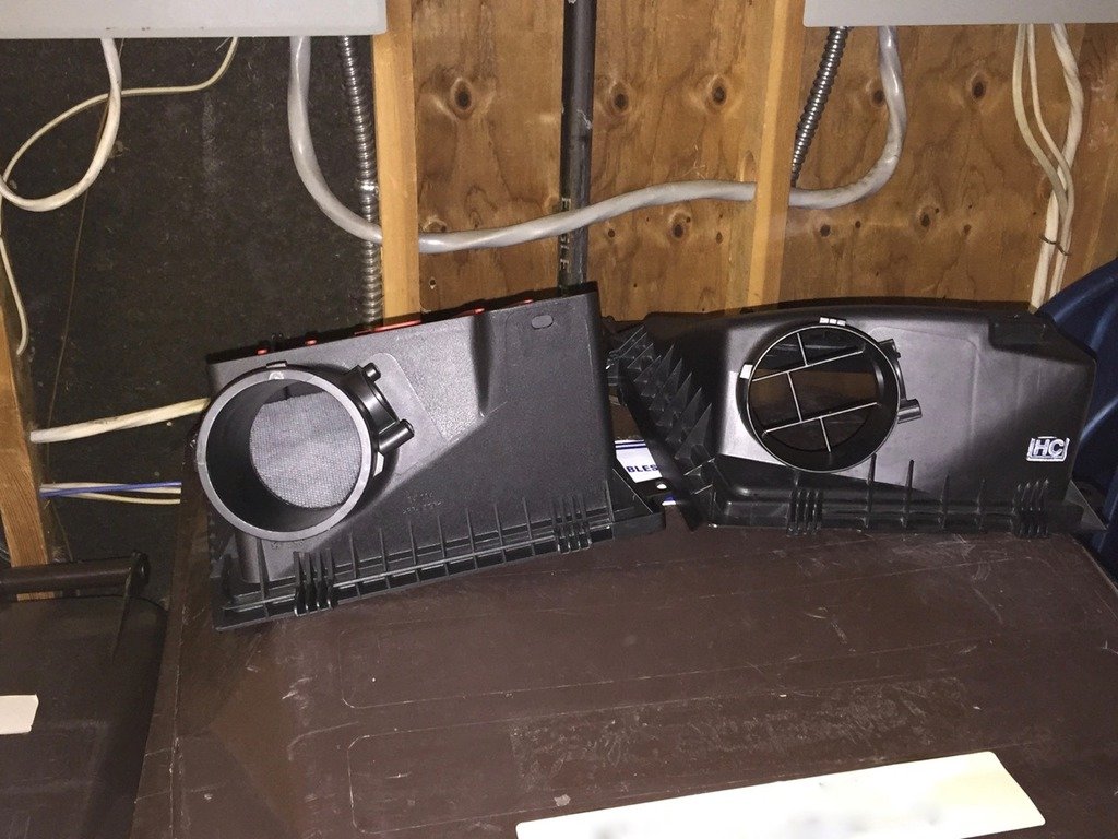

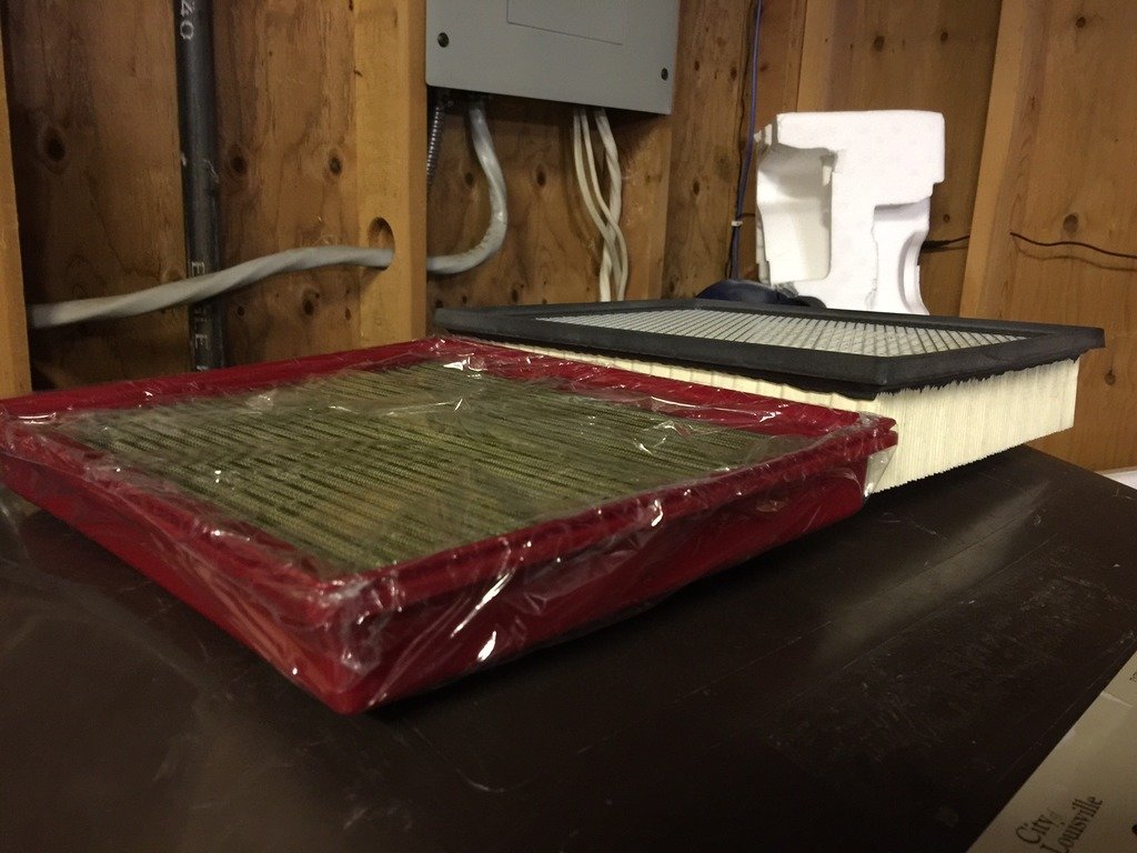

    Also, to be clear, this intake isn't simply a TRD stamped box with a TRD high flow airfilter. The upgrades are as follows:
    1.) The portion of the intake that goes into the fender is different. The stock box has an elbow type plastic fitting that slips into the fender opening. This is where colder air is pulled. The TRD intake kit comes with an air horn/flow accelerator (#8 in the diagram) made of rubber. It's larger in diameter (better air flow) and fully seals around the fender opening forcing the intake to only pull the colder air from within the fender. It also doesn't have any angles or bends and basically dumps right into the fender.
    2.) The intake "plumbing" is also less restrictive. There is still a resonator but it's smaller than stock and the piping that connects the resonator to the intake tube is much smaller in diameter meaning less air restriction compared to stock (less places for the air to travel on its way to the throttle body). I'm assuming the TRD engineers thought a resonator was still needed as to not make the sound obnoxious. They designed it as minimal as they could from my point of view.
    3.) And lastly, the TRD air filter is about 2/3 the height of the stock filter. It also has a different construction and material that allows higher flow. It uses oil and is reusable.
    4.) The only part of this kit that is all show is the top portion of the air box. This has the TRD lettering stamped into it. Apparently there are some differences between the top lids. In the picture below, on the TRD version (left side), you can see that not only is the intake hole material thicker but it also removes the plastic grid that you can see on the stock unit (right side). The TRD lid's intake hole is also angled to be more straight so the entire path of airflow is more of a straight shot as opposed to the stock system that is more curved. It's ALSO a nice cosmetic addition that brings it all together.
    NOTE: It's very easy to forget to install the flow accelerator/air horn in the fender. Don't forget to do this as this is an integral part of this intake kit. It's the rubber horn looking thing (actually, I believe they refer to it as a horn in the instructions. Also, everything lined up and came together very seamlessly. There are notches and grooves on the couplers and pipes to make installation guess free. Nice job, Toyota!
