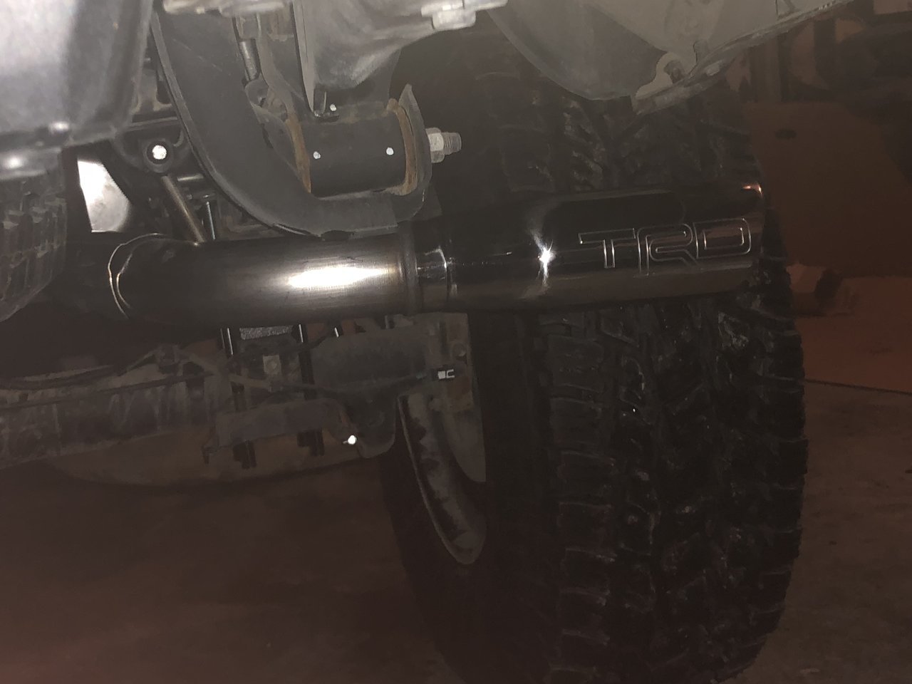

    looking to purchase the TRD exhaust system and was wondering if anyone has done an install on this? If so, how difficult was it and are there additional parts required to install it?

    Did it yesterday, took 15 minutes.
    2 bolts
    4 rubber insulators

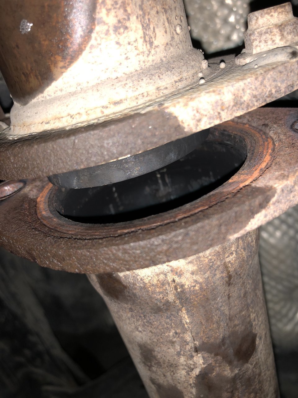

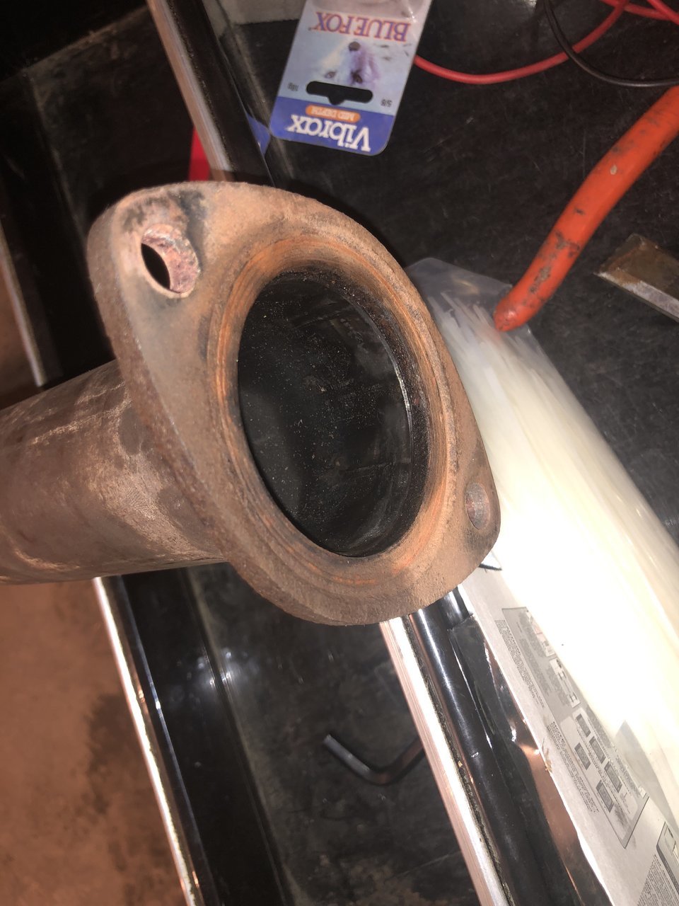

    How did you get that gasket out?? Also any tips for the rubber hangers?

    Any hints on getting the gasket out???

    Id use a scribe, 90 degree would work good. You can see where the gasket meets the pipe inside. just take the scribe and work it between the two surfaces, also working around as you go.

    Thanks, I bought a new gasket, tried and tried to get old gasket out... decided screw it, installed new exhaust with old gasket and Zero leak!
