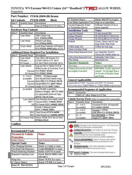

    They are not real beadlocks. I had them on my previous 2011 TX (RIP). Attached is the sheet that should have all the part #'s. From what I have seen these are very hard to get ahold of and I don't know if they make the black ones anymore (I could be wrong).

    I went chasing down a set for my truck back in Nov. Here's what I know:
    As stated above:
    PTR18-35090 - Black Beadlock Wheel
    PTR18-35090BR - Bronze/Gold Beadlock Wheel
    PTR18-35090GR - Graphite Beadlock Wheel (TRD Baja TX)
    PTR18-35091 - Trim Ring
    PTR18-35092 - Center Cap
    PTR18-35093 - Trim Ring Bolts
    PTR18-35094 - Also listed as a center cap...cannot locate pictures though.
    You cannot order the Gray Baja wheels from dealers. I called over 20 when I went looking and got stonewalled on every single one. They are limited release and most dealers I talked to told me even if I had a Baja model, the chance of being able to secure 4 at once might be very, very difficult.
    While the Black wheels were intended to be the same way, apparently they are easier to get ahold of.
    I bought my initial four from www.trdparts4u.com. At the time they had said on their website they had the last 4 they could get. I had placed the order with the note that I wanted the black beadlocks, not the bronze and to call me if they had any issues. When I spoke with them on the phone they told me that they had two in stock and were going to attempt to secure two more for me. However, given the clampdown they saw on the wheels, they weren't sure they could get me the other two, but they would try and if they were unable they would refund me. They ultimately put in the order for those wheels and were able to get them for me. However, they've since taken them off of their website, which leads me to believe they're a deadend source.
    I decided after that I would go after a 5th wheel, just in case I ran into any issues with mine. I ordered my 5th one from www.shoptrd.com - here. I put in the comments that I wanted the black beadlock wheel and was able to get one with no issues.
    The frustrating part of this equation is price. I had found TRDparts4U first, and paid $259.xx + shipping for each wheel. ShopTRD offered the same wheel for $220.xx and free shipping. So I could have (in theory) gotten 5 wheels for the price of 4. Lessons learned, I suppose. I searched high and low for the wheels and they are the only vendor left that I has them, I believe.
    Happy hunting.
