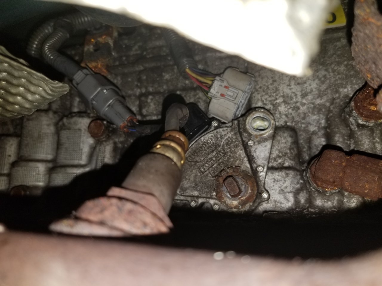

    Similar issue here..... I have three Toyotas and my Tacoma has not gotten a lot of recent use. I got into it today to bring my 4 dogs to the vet and I got a check engine light as well as a traction control light on the dash. 300k miles on this Tacoma and relatively few issues. VERY difficult to shift between gears. Not impossible but noticeably more difficult than I remember. I cleared my p0705 code and it has not come back ...yet but I know it will. The p0705 code refers to the transmission range sensor, not the neutral safety switch which is what I am not understanding. Are they one and the same or two different items? By the grace of Toyota the neutral switch is relatively easy to access so I was thinking of swapping that out and see what happens. $130 and an hour or two of my time. I don't see how an electronic position switch would effect the difficulty of physical shifting though. Anyone have any thoughts, prayers or thoughtful suggestions?

    The Transmission Range Switch and Park/Neutral Position Switch are the same thing albeit two separate circuits within the same switch.
    They get corroded especially in areas where salt/corrosive chemicals are used on the roads and sieze causing the transmission shift linkage to bind and/or the P0705 code.
    Check the connector as well, it's common for it to get corrsion in it as well.

    I thank you for taking the time to reply to an issue that has probably been discussed a lot already. When I was under the truck in my preliminary inspection to get the lay of the land I did check the connections. Everything looked good but I will certainly clean them off inside and out. I am in the northeast where they salt everything at the drop of a hat. My Tacoma has 300k miles on it and I use it for towing so it is in and around salt and salt water every day. I am actually online now looking for a replacement rear bumper. It made it through ten years of punishment. Sadly it rusted out from the inside and disintegrated seemingly overnight. I always have concerns about reliability so even if I find the connections are clean I will likely replace the switch anyway. I can't afford to get stuck if the switch finally decides to go. Reading the experiences of others I see the vehicle may not move if the switch does fail. The switch itself is not too expensive and fortunately not located somewhere that inconvenient. Thanks again for your input.
