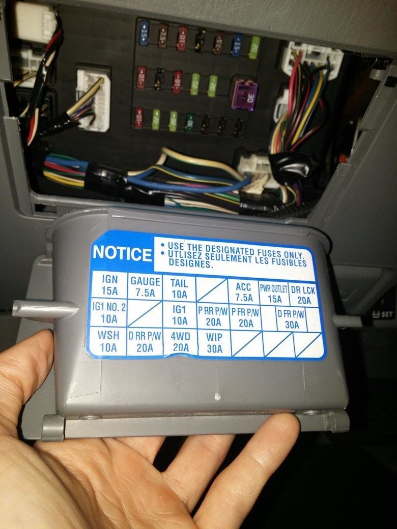

    Check your IG1 fuse in the dash before anything else.
  5. Apr 8, 2017 at 1:52 PM
    greghart007
    greghart007 New Member
    Apr 8, 2017
    #215728
    Checked my IG1 fuse under the hood, Replaced it, Engine light went right off!
    toytaco97... You are the BEST my friend!
    Thanks!

    Where exactly is this IG1 fuse?
