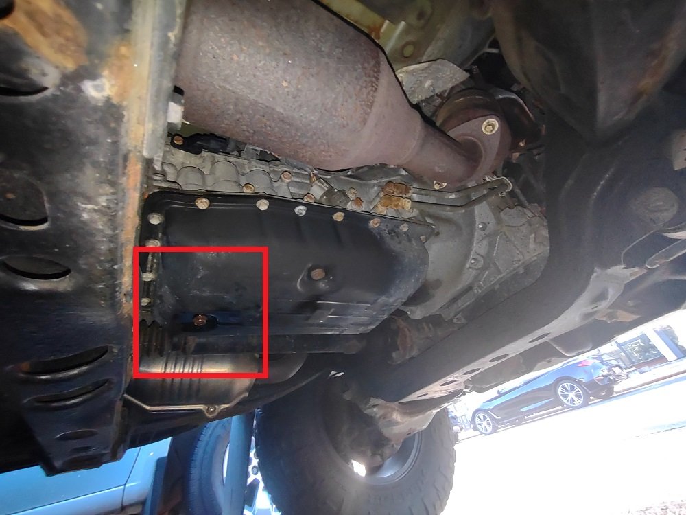

    I had a weird feeling when I was changing my oil last night (something I have done numerous times) because the "oil" had a reddish tint. I am now convinced that I somehow completely forgot how to change my oil since the last time I did it and I actually drained all of my transmission fluid out and have 11 quarts of oil (old and new) in my engine block now. Just to confirm my idiocy... this plug here is the transmission fluid plug, correct? I've already driven my car to work in the current condition. Assuming my suspicions are correct. What now? Would I be OK driving it back home to fix the problem if I add some transmission fluid or should I have it towed?

    Yes, that’s the Transmission Drain Plug.
    I’d refrain from driving the truck until you have the correct amount of fluid in both the Engine and Transmission.

    I think I was just tired/rushing through it, because yes that pan is obviously underneath he tranny. That being said, I could easily see how someone would do this (it appears to happen a lot). The transmission drain plug is more easily seen and accessible and I have no idea why Toyota doesn't at least mark them in some way.

    No vehicle ever marks them. The transmission drain plug is in the transmission and the engine oil drain plug is in the engine.

    OP don’t take the criticism above too hard. It’s happened many times. Others have don’t the same thing. And even driven just as you did. The worst part of the whole situation will be getting the transmission fluid to the correct level.
    If going off prior post from others that did the same thing. You probably didn’t damage anything yet. Just don’t drive it any further if you can.
    And for all those wondering how it holds 11 qts. Well, the 3.4 in the first Gen will too. This isn’t a new phenomenon, it’s been happening since the 1st Gen Tacoma came out.

    I have driven it 9 miles. Nothing felt weird. No lights came on, or anything. But I am positive the thing had all tranny fluid drained and had an additional 5.5 quarts added. I don't know but it's at the shop now and they are going to assess my stupidity.:fingerscrossed:

    You did not drain the full trans, only the pan. While terribly low, not empty. Your 9 miles may not have created much harm. At this point a proper fill with the right fluid and 'wait and see' is the practical assessment.
    Engine overfilled isnt good, but again only 9 miles is your salvation. A drain/refill is really all to be done at this point.
