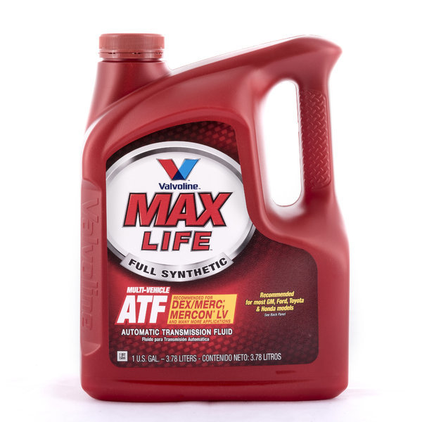

    I've flushed all my Toyota products with Valvoline MaxLife Dex/Merc; Mercon LV. Two call for WS and two for Type IV. MaxLife is compatible with both types ATF. I would change out the ATF filter, but since it appears a flush has never been done on this, relatively, high mileage vehicle, I would not yet do a flush yet. Only a drain/refill and change of filter, then another drain/refill every 30K, then a full flush after the forth drain/refill.

    Just be careful because there's two types of Maxlife ATF. The one you need will say "full synthetic" on the front of the bottle, and on the back it should list it as compatible with Toyota WS fluid.

    Also if you buy the quart bottles, make sure you don't get the stop leak version. There's also the blue dex/merc jug, it's the older spec dex 3 stuff. You want the Maxlife dex/merc in the red jug. IMG_4773.jpg
