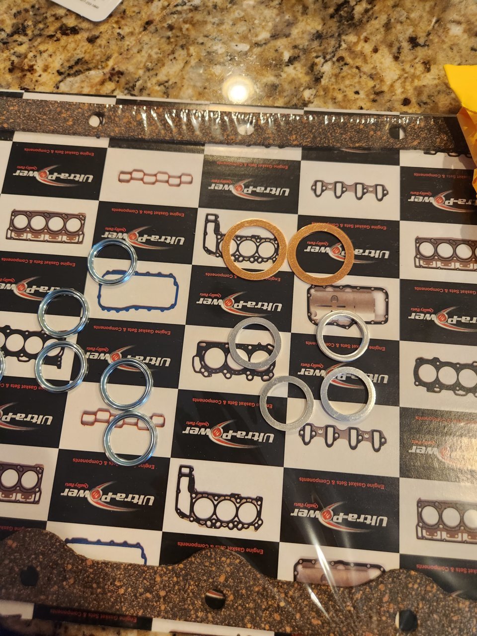

  8. Oct 14, 2022 at 8:43 PM
    Kwikvette
    Kwikvette Chief Executive Officer at Kwik Fab
    Feb 27, 2019
    #284735
    75,056
    Fresno County
    Stock
  9. Oct 14, 2022 at 8:48 PM
    cone of shame
    cone of shame Member
    Oct 7, 2020
    #343158
    17
    Denver
    02 TRD NY -> AK -> CO
    Salt spray and rock chips.

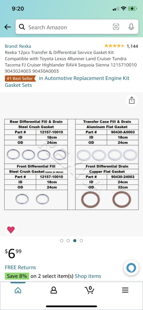

    The size is 18mm, but don't get the pack of fiber washers from AutoZone, they never seal properly.
    Toyota sells this size crush washer in steel, aluminum, and copper (as seen in the kit linked above). I believe the transmission calls for aluminum washers -- BUT these are so cheap and it will be years before you need another one, there's really no need to guess or improvise or try to save money here. Galvanic corrosion sucks just as much as a perpetual fluid leak.

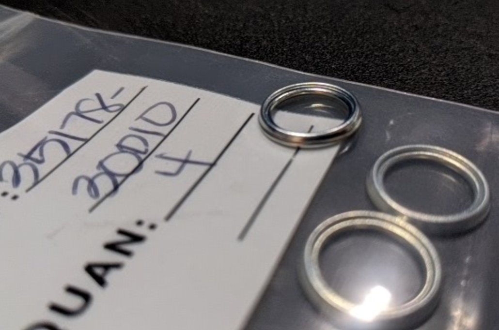

    EDIT: Updated with both MT and AT part#s. 15ftlbs for the drain pan plug (corrected, typo).
    R150 (MT) Drain/Filler plugs:
    90341A0002
    R150 (MT) Drain/Fill plug gasket:
    9043018008
    A340E/A340F (AT) Drain plug is:
    9034110011
    A340E/A340F (AT) Crush washers for trans drain plug are:
    3517830010
    When installing the crush washer for the 340E/F, you want to face the rounded side of the crush washer facing the pan.
    (Pictured: A340E/A340F crush washer)

    That listing says "cm" when it clearly should be "mm". It makes my skin crawl and makes me not particularly trust the seller.
    This is a lot of heartache to avoid calling the dealer's parts desk.
