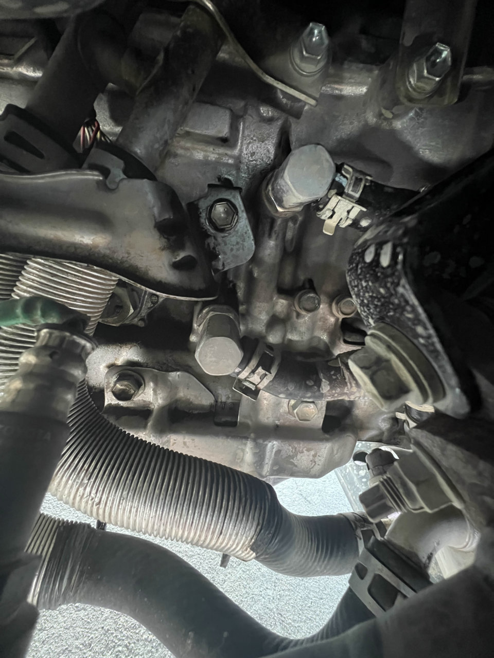

    I have a 2021 4X4 OR DCSB and had a warranty issue with the factory lines to the cooler. Photos attached, but one day I noticed a drip on the driveway and took it in to the dealer. They completely replaced the hoses, fittings, and clamps. I did have a bit of a heart palpitation given my noticeable part upgrades, but the service guys told me they had seen this on other vehicles from earlier model years. Unsettling, but great to have it fixed and back on a dry driveway. Note, photos from underneath were taken from the passenger side. Leaking OEM cooler line fittings.HEIC.jpg Trans pan.HEIC.jpg New cooler line and fittings.HEIC.jpg Truck.jpg
