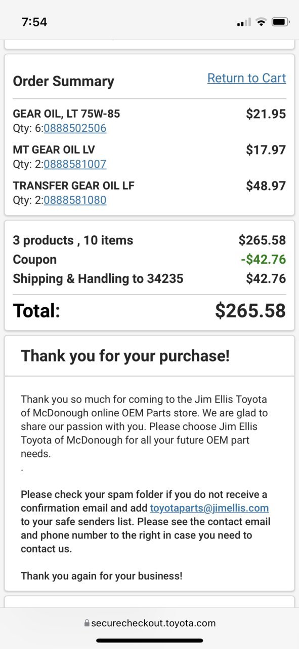

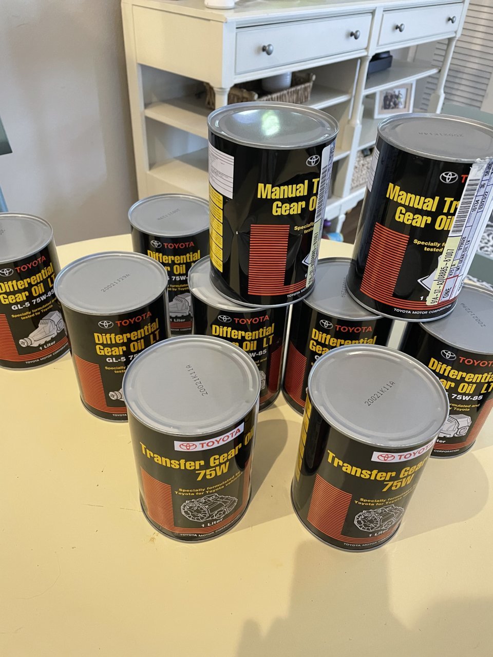

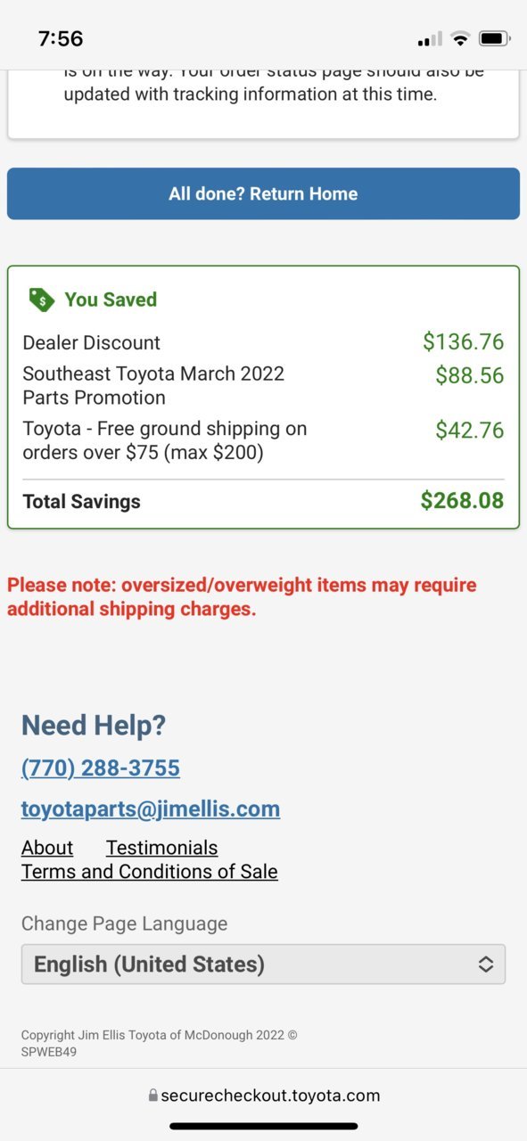

    Toyota just had a 25% off sale. Bought all my fluids and shipped them free using their discount code. 275D89A3-7FB2-4231-98CE-7BD3B8BA6134.jpg7FCC87CB-ABBA-4414-8830-38823D30448B.jpg
