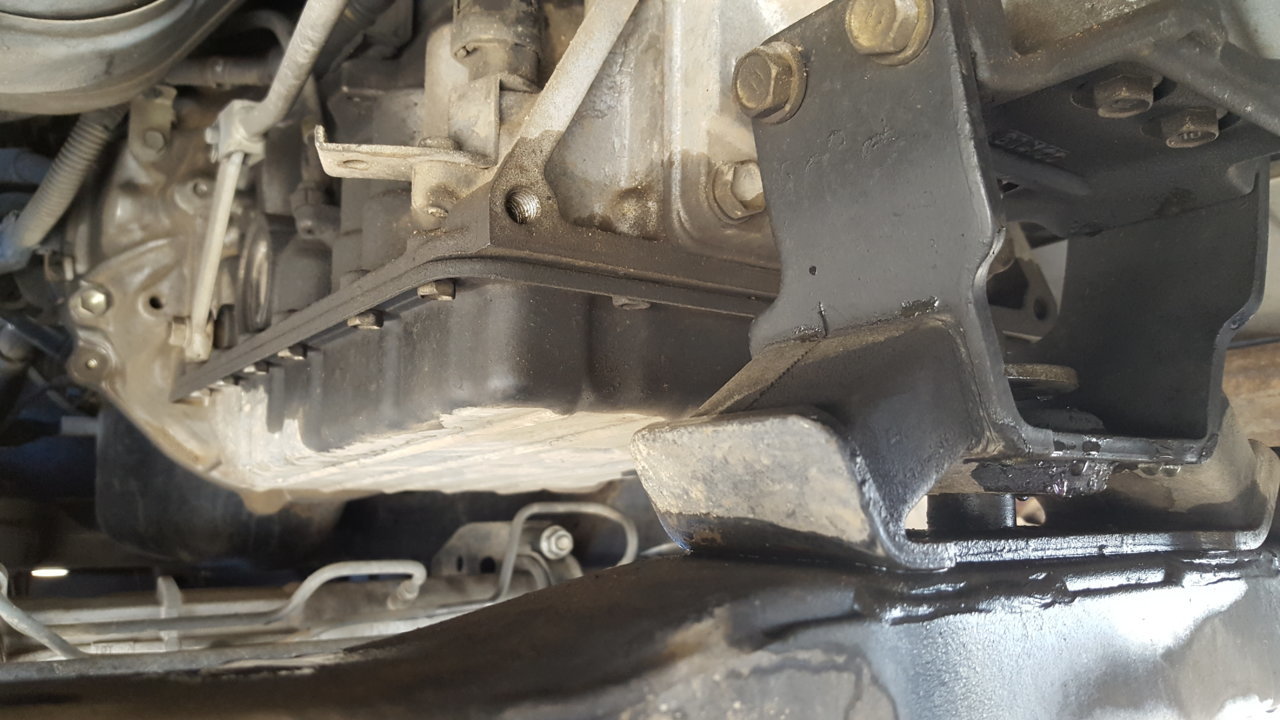

    @Arbys Tacoma why don't you or your niece get underneath the truck and take pictures of any "wet" spots?
    Also, as stated, no transfer case exists in your niece's truck seeing as how it is a 2 wheel drive so let's assume they mean transmission.
    I just recently developed a transmission leak (3-4 days ago) but it came from my transmission oil pan -
    If the leak looks like that, it's just your pan's gasket. Easy fix, just messy.
    GQ7227 likes this.
