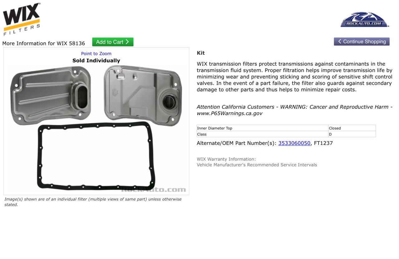

    Wix makes a Trans filter.
    I’ve never used their filter on my Trans, but I would. (I’m still running my OEM filter)
    I trust Wix.
    $23.99 on RockAuto

    I did mine just over a year ago. Full flush and pan drop. I used Maxlife and a Wix filter and gasket. No problems.

    Our transmissions don't have a "filter", rather it is a "screen". I believe the difference is the size of the particulate matter that gets filtered/strained out of the fluid.
    That being said, I also suggest you get a new one. I run WIX and MaxLife in my transmission. I have also installed an external transmission filter, as I do not think the screen cleans the fluid sufficiently.

    I ordered the OE filter (35330-60050) for $43.41 and the pan gasket (35168-60010) for $17.62 from an online parts shop (in this case it was Boch/EB Toyota Scion). You can find it from other Toyota retailers like McGeorge, ToyotaPartsDeal, et al. for nearly the same price. More expensive than aftermarket but it's OE and still less than a local stealership.
