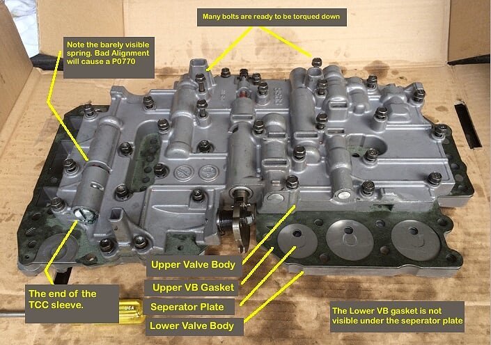

    It's not difficult. You'll need to pull the pan and then attach the cable. The difficult part is crimping. Be sure to get that measurement correct or you may encounter shift issues.
    Toyota Orange FIPG for the pan and probably need one of these (or something similar https://www.amazon.com/Lisle-50210-Gasket-Separator/dp/B09NMH7TY4/) to make it easy to remove the pan. Be sure to clean both surfaces of any old FIPG before applying new and resealing.
    The FSM calls for the valve body to be removed but its not necessary. There is a video floating about youtube which shows how to feed it in and attach it with the pan off. I will see if I can find it.

    That video is the one I mentioned but couldn't locate. While not the same it's completely similar in that the VB doesn't have to be removed. Once you drop the transmission pan, you'll see it. Time stamped -
