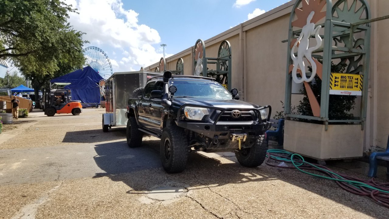

    We just bought this which is a 6x12 v nose. I debated tandem but did t need the extra weight capacity. Doesn't sway and we have been very happy with it
    Bebop and Muddinfun like this.
