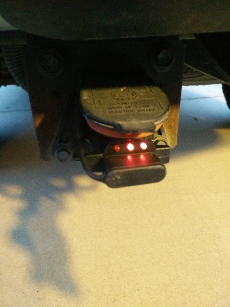

    To make a long story short... I have been getting my dads trailer back to working order and had to convert the trailer from a 4 pin to 7 pin add trailer brakes etc.. I got the lights working on the trailer, except the marker lights.. After troubleshooting I found the issue to be my truck..
    I have a 7pin > 4pin adapter that has lights for testing.. When turning on the head lights the (TM) light does not illuminate. The left and right test lights work as expected..
    I checked the ground, as every thread suggests, and I believe the harness is a factory harness. I have also verified the fuses under the dash are good. I didn't know how to test the one under the hood so I didn't really check that.. Is there something else I should check?
    The picture below shows the truck with the lights on, and the hazards on..

    Basic troubleshooting. Grab a multimeter and check for voltage starting at the plug andwork forward until you find power.
    Or bypass all troubleshooting and just run a new wire.

    I went during lunch today and bought a new fuse for one of the fuses under the hood.. Everything works normal now
