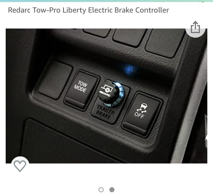

    What are you planing on using for a controller?? I am looking at using a knob type to keep a clean factory look.

    I like the knob idea, , but it’s a little pricier than I want to go. I’m not sure what brand yet though. I may try that. The more I look at the other styles I think I like the look at that better

    It's behind the panel, very easy install. I personally have a Tekonsha with the MESO customs replacement panel.

    Fire the fellow cheap-asses out there, I've been running a Tekonsha Primus IQ for about 5 years now. It has all the features that you need in a brake controller, and none of the frills you don't. Install isn't the prettiest, though.

    I went this way because I couldn't get a location the controller from my Jeep Liberty would fit that I wouldn't hit my knee on. It's a good controller.
    The wire is way back under the kick panel cover. It's back behind a bundle of wires and not easy to find with out really looking for it good.
    I used that for years in my Jeep. It is a good basic one that does everything you need. I just didn't like how it was going to look in the truck and figured I'd bump my knee on it all the time so I let it go to the with the jeep

    Redarc, is the cleanest, easiest way to add a brake controller to the 3rd gen, in my opinion. also, no more stepping on the brake to start with the push button start. push the redarc button in, while pushing the start button... viola, no getting in and out, to start the truck. Ski
