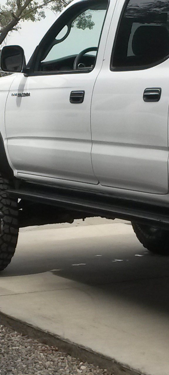

    031.jpg Got the bolt on, but welded them on, they have paid for themselves many times over.

    image.jpg Never recommend for bolt on unless you plan to run only on blacktop. Mines were weld on
