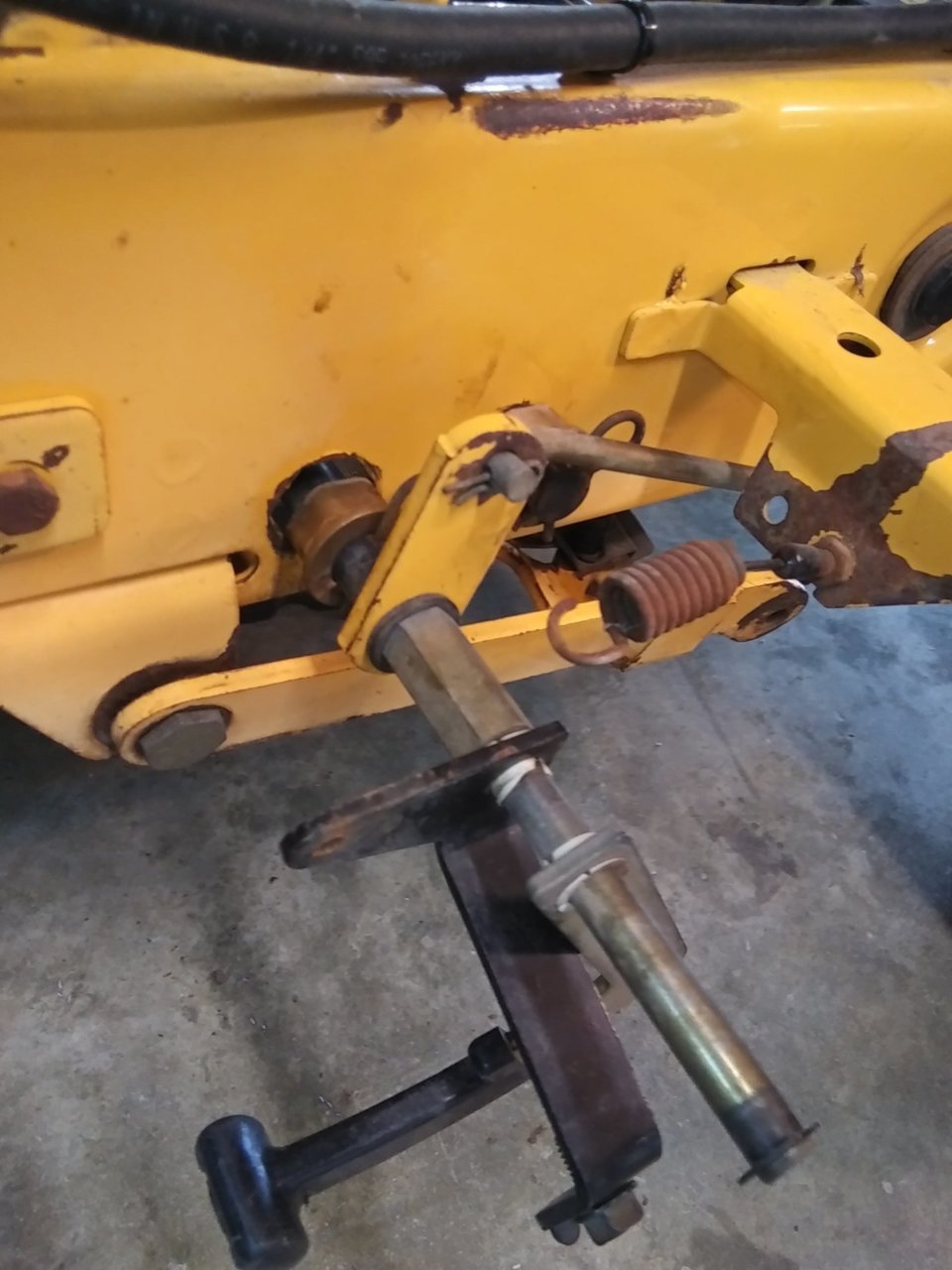

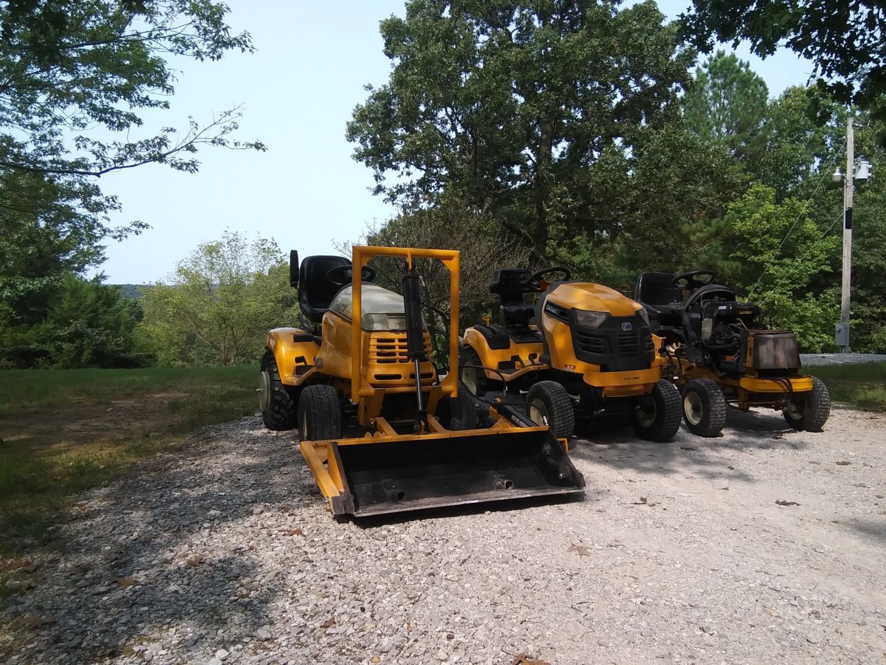

    Working on my 3205 today and pulled all the tractors out for a group photo. I may like Cub Cadets a bit. :D

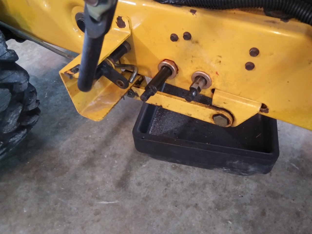

    Replaced all the bronze pedal control shaft bushings in the frame on the 3205 as they were binding and turning in the frame rather than on the shafts--they have hex shaped holes in the frame and they were wearing the on hex holes.

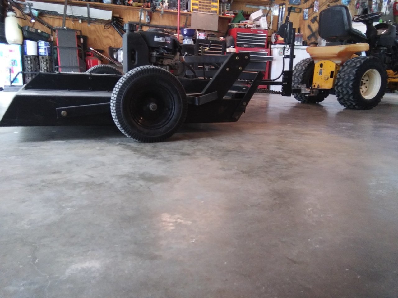

    Then pulled the brush hog in to lower the hitch down since when I fixed it last week it was ~5" higher than before. Got it to where the blades are 4.5" in front/5" in the rear. Angled front down as I don't like 3" hunks of wood and rocks whizzing past my head(true story)

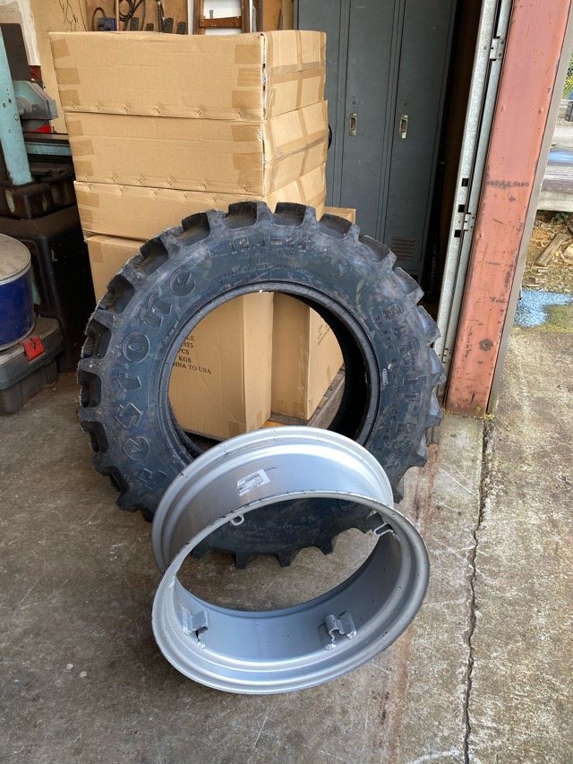

    I was feeling froggy this morning. I think taking it off was worse than putting it on.

    It's always harder getting them off. Those are some strange punctures. I'm almost wondering about a disgruntled employee or dumb kid with a knife.

    A knife had to have been what it was, picked the new one up yesterday afternoon and the guy at the tire shop just shook his head. Hopefully whoever supplied it to him will take care of it, they weren’t at his shop 10 minutes when they got delivered before I picked them up the first time and they sat out by the door when he got them so I wouldn’t think it happened at his shop.

    <20 minutes we are remounted and ready to roll. I inspected this tire before mounting it, hopefully all is good now.

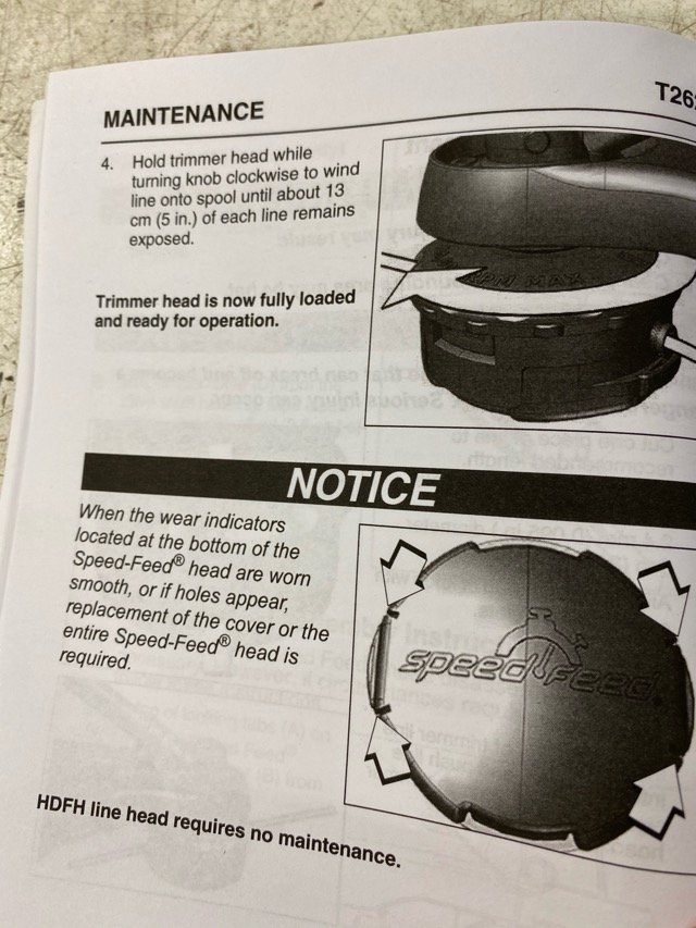

    I bought a Stihl BR200 blower, it's alright for what it is and weighing 12 lbs is awesome. I sold my BR600 to a friend of mine who mows yards yesterday and we got to talking about weedeaters.
    He said he liked his Echo's, I said I bought a Shindaiwa (made by Echo) this summer and like everything but the string replacement, the head is hard to get back together with the string wrapped without it coming apart.
    He said "you haven't read the manual have you?" I said no, he said I couldn't stand mine the 1st two times I re-wrapped it then read the manual. It's actually simple and you will like it once you figure it out. He said does it have a hole through it? I said yes. I went and got my manual. :facepalm:

    Bwahahaha!!! Don’t worry Creed, you just made me do the same thing! :facepalm:
    I’ve been running a Sthil FS100 RX straight shaft trimmer for years, the wife offered to get me a Milwaukee M18 pole saw/trimmer interchangeable kit for Father’s Day, I used the trimmer until it was out of string, opened it up, got frustrated (yes, it has a hole like yours)
    Then tossed it on the rack and grabbed the Sthil.
    Looks like I’ll be taking that off the shelf and having a humbling moment with it this weekend!
