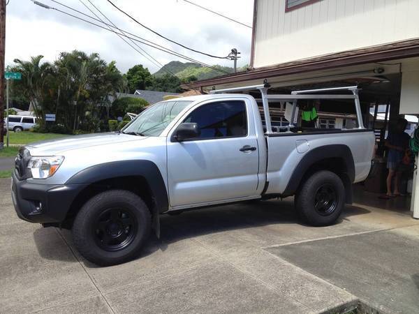

    I have that rack on my 14'. It is quite tall and looks a little odd unmodified. When I got mine I put my sup board on the rack without any padding. The nose was @ 2 1/2" above the roof. I disassembled the rack and trimmed the vertical legs 2 1/2". The idea was that when I mounted the board I would have a towel or some sort of padding under it. With the padding the nose would than clear the roof. Cutting the vertical legs was done with a hacksaw. The biggest hassle was tapping new threads in the legs. Otherwise the rack works great. The pic is with it trimmed 2 1/2".

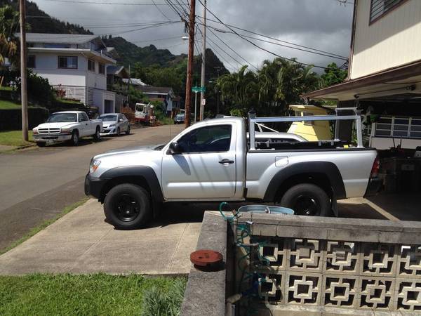

    I have the universal trac one from home depot. Does everything I ask of it from carrying my SUP, fishing poles, lumber, etc. I did cut down the uprights and re tapped the holes for the mounting hardware so it doesn't stick up so much. I also cut the width down a little on the horizontal cross pieces. Heres a pic from when I first installed after modification:
    Later I added aluminum rectangle tubing to reinforce for heavier loads and so that I can put tarp over to make a camper/shade for days at the beach.
    Tools used: Metal cutting saw, tap and die set
    And yes I was in the same boat as you, $300 something is way better $600+. Just make sure if you do get the universal rack that you purchase the tacoma mounting kit that allows you to bolt to the rails in the bed. The mounting brackets in the universal kit do not fit our trucks. I bought the tacoma mounting kit from go bananas in Aiea.
