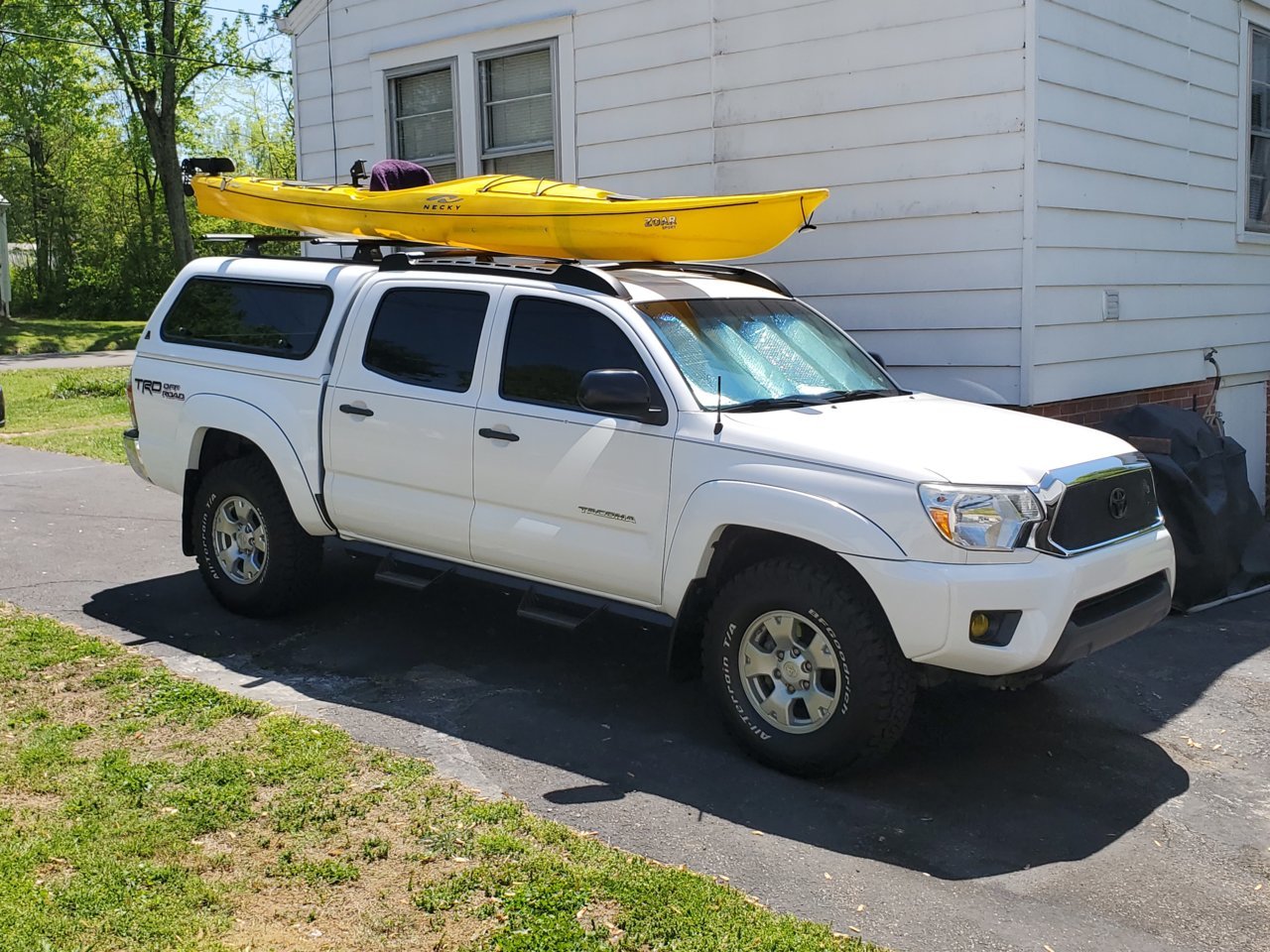

    Just got me a camper shell for my taco. I want to put a roof rack on it and I’m torn between a tracked system or straight up bolting the racks to the shell.
    My question is if I’ll really be missing anything without tracks other than aesthetics?
    Ill really only be using them for a kayak or moving lumber. EABFE94F-CD34-4DA2-99FE-CAF6743D1D69.jpgF20E76B1-BCCA-4787-B7AD-36148EB81B49.jpg

    I bought my truck used with the shell and tracks on it already, so I bought bars to fit the existing tracks.
    If I had it to do over I would probably go with no tracks and bolt on some bars. Much cheaper that way.
    The tracks are great if you have a lot of different attachments for your toys and need the adjustability, but like you I just need to haul lumber or maybe a ladder once in a while and would probably never adjust the bars on the tracks.

    Wouldnt tracks help distribute the load and lower the risk of stress cracks?

    I added tracks on my camper shell for kayaks. I also added a factory roof rack. I can slide the racks on the camper shell to make adjustments when needed for our 10ft kayaks or my 14 kayak, ladders, lumber, awning, etc... I wish the front racks adjusted like the tracks on camper so stuff would lay flat on the front racks.
    the tracks can also carry more weight. the tracks needed about 5 bolts instead of 2 bolts holding a bracket or foot. imagine dragging that kayak a few hours on top at highway speeds. it could cause stress cracks on the camper.
    I researched the two types until my brain hurt and went with the track.
    when mounting whatever system that you decide on make sure to use silicon or some kind of sealant to keep water from getting in the holes you drilled to mount. if water gets in and freezes you'll have tons of cracks.

    When i bought my cap, it came with a 2 piece rack bolted directly into the cap without tracks. I thought I would like it but after a while, I noticed you can do so much more with tracks. Trust me, don't do what I did and just put tracks on. Then you can add a 2 piece Yakima, a full size prinsu, a kayak carrier......your options are endless.
