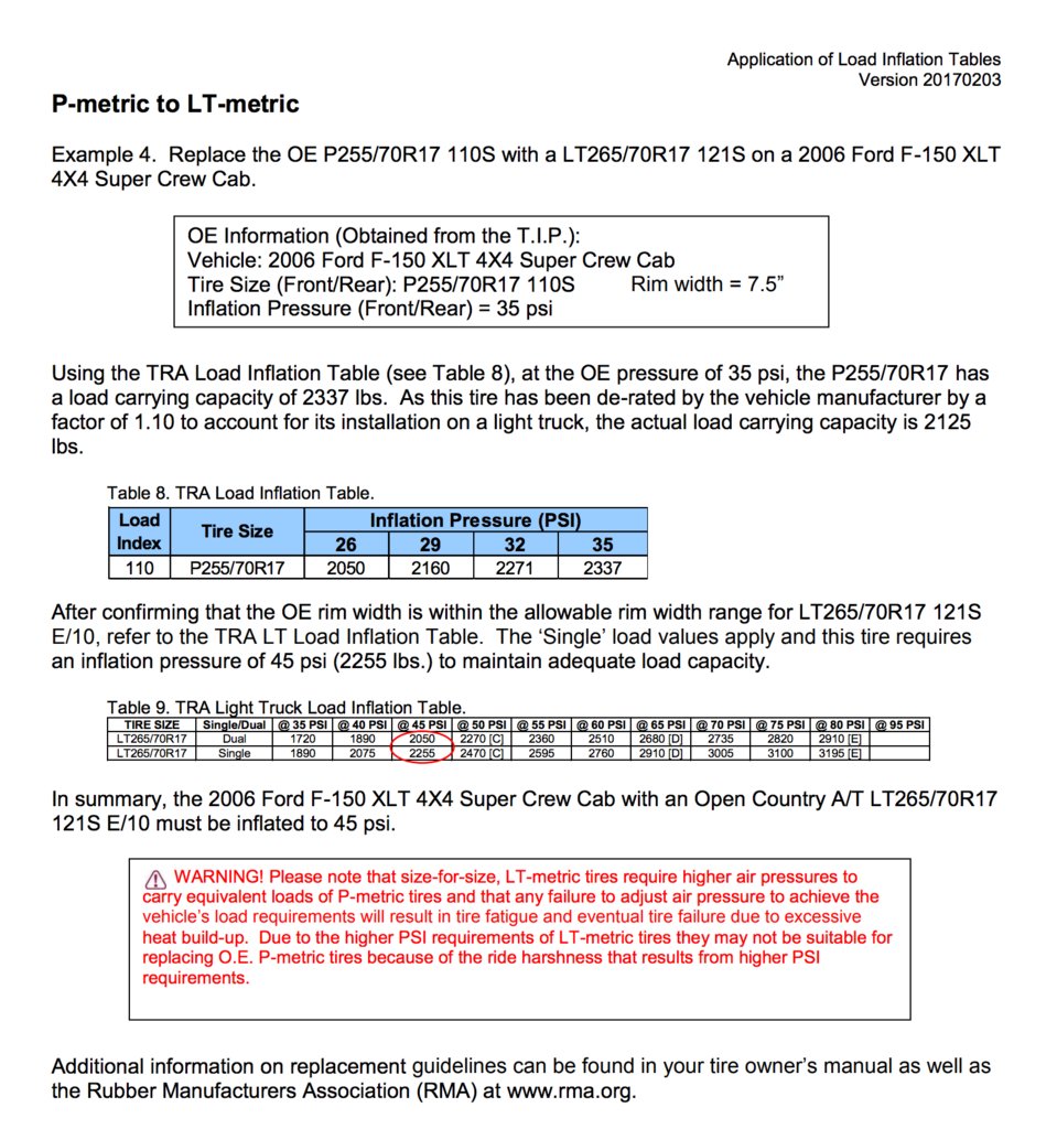

    I run my tires at 65psi but it seems the max reading of the TPMS sensors is 55.
    Anyone know if this is a limit of the sensors or if a recalibration can alter the range?
    I am not running stock tires...I switched to E load range Cooper/Mastercraft Coursers of a different size.
    Edit:
    I found this helpful to understand how to derive the correct tire pressure when changing to non-OEM tire types and sizes.
    https://toyo-arhxo0vh6d1oh9i0c.stac...ication_of_load_inflation_tables_20170203.pdf

    why are you running 65psi on a Tacoma? You'll meet the max load requirements at like 40psi already with e load tires.

    You realize the psi on the sidewall of tires is the max psi not the recommended? On a Tacoma you should be running around 35. I run 32 with my E range tires.
