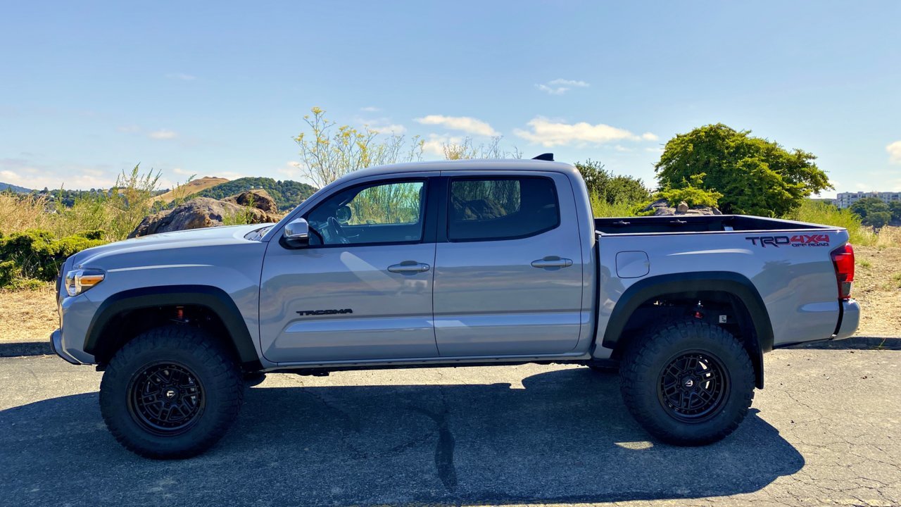

    I've been running the toytec package on my 2019 DCSB for about 8 months now.
    I got this:
    Toytec Boss 2.5 Aluma Series Performance Suspension
    kit included SPC UCAs, and full rear leaf packs
    Here's a pic:
    I've been really happy with the ride. I've taken it wheeling in the mud a little bit, and a fair amount of washboard/dirt roads. No hardcore crawling of any sort.
    For my use, which is 95% on road, its preserved the quality stock ride, while leveling, adding some height, and also giving me an offroad option for bigger tires.
    Once or twice I have noticed an 'odd sound' coming from my drivers front on sudden compression. I don't think it's a rubing sound. May be a defect in the shock, but it's so extremely rare, I'm not concerned.

    Jba’s are a must if not your sway bar will hit the spring very happy with the jbas as well plus you get a slick look as well. I have the all pro aluminum apex bumper with winch and all the goodies but i think you will be happy. As do i plan to keep the truck forever going on 10yrs already and no major problems well none at all really

    Check the bushings see if they are starting to roll out if not check for wear on the spring could be hitting somehwere. Ie swaybar, control arm etc
