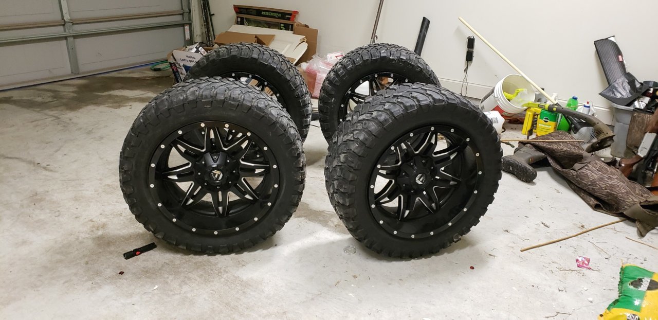

    Buy Tacoma lug nuts .drill and tap to Chevy thread pitch.problem solved...buy hub bore spacer on Amazon or make them at your local machine shop

    I will be doing this in the next month with these off of Tacoma
