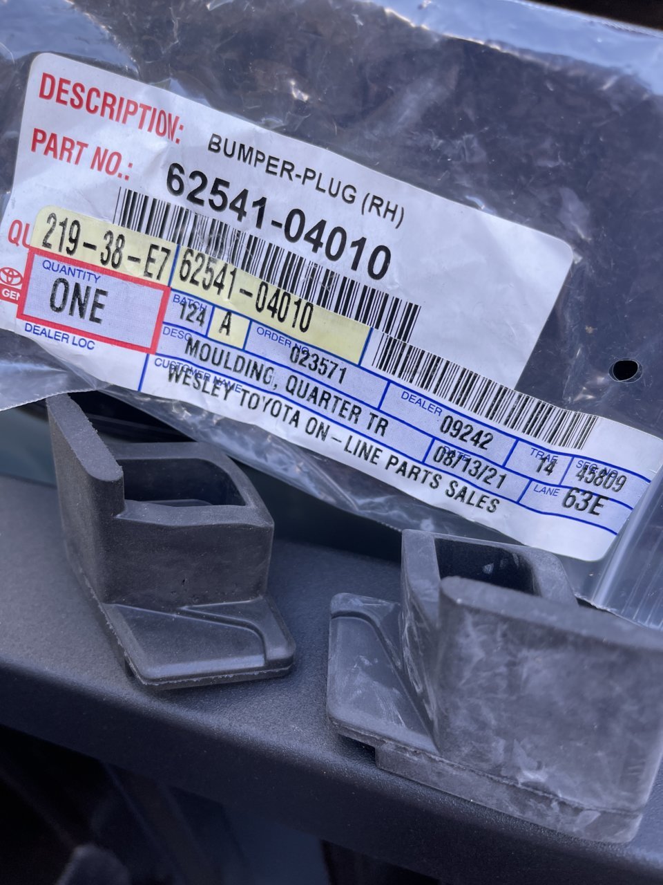

    How exactly this is instaled can’t find anything! Got left and right. Thanks

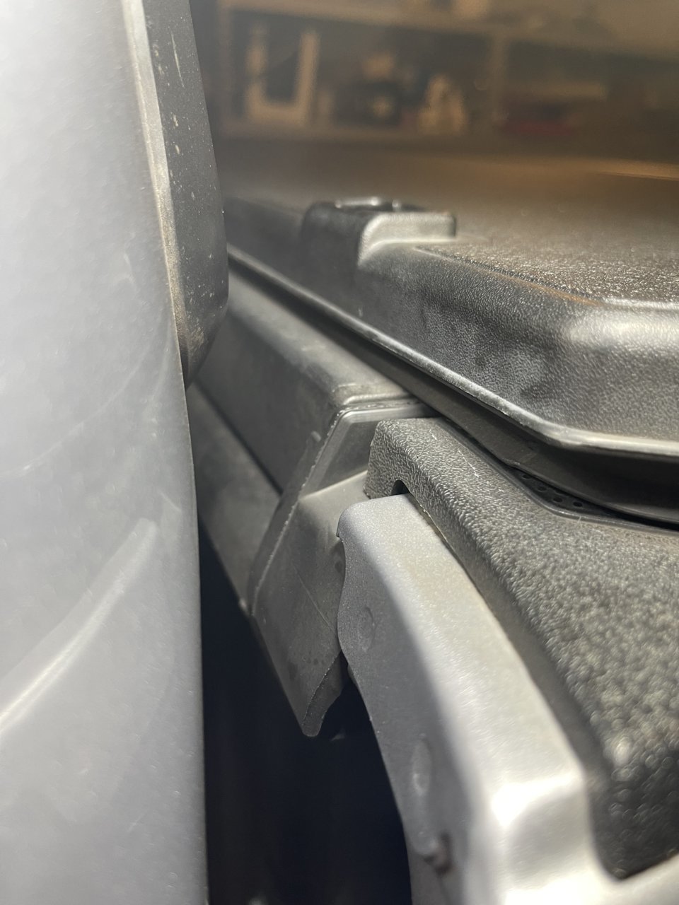

    Probably the best photo I can show you without taking the cover off.

    Thank you very much! Now I wonder how im going to make this work

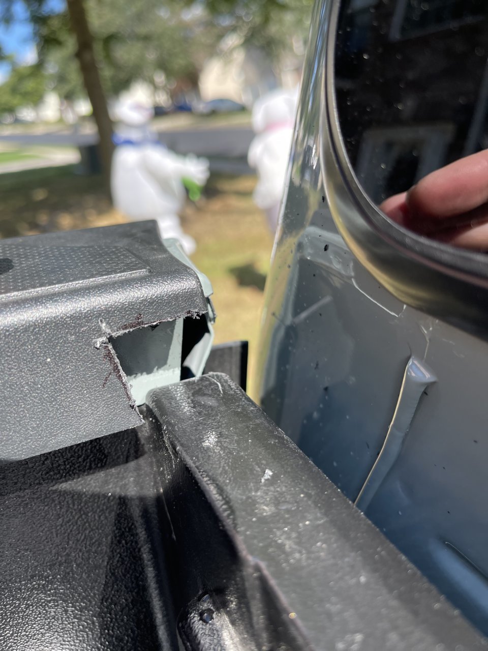

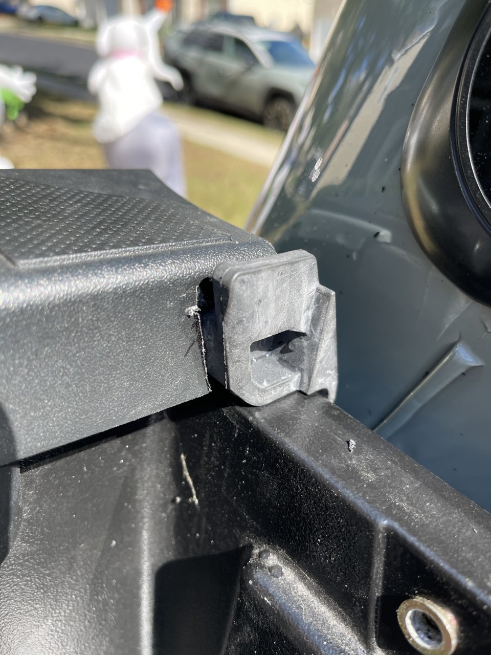

    Remove the bed header piece (5~6 torx screws), pop out the end plugs, replace them with the new plugs, replace header header piece.
    Be careful using the torx bit, those screw heads are notorious for stripping out the head.

    EB67A2B5-DCDD-4C14-A382-D9690E041A75.jpg 2CA536AF-12D0-4E27-A26F-D85FC274E8F5.jpg i did striped one of the screws But I managed. I modified the rails, not perfect but I am happy with the result. Thank you all.

    Genuine Toyota Moulding Quarter TR 62542-04010
