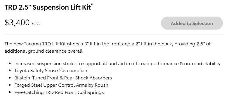

    The one you linked is the one I’m talking about. The one listed on the upper right side of that price sheet. The $3400 TRD suspension lift.
    I just picked up my 2025 TRD OR last week and was at the dealer going through the process of them trying to sell me add-ons. I asked specifically about adding on that kit, and they told me that it was not available and not being sold at the moment. That sales person told me there was a stop sale on it because some part on it kept breaking. They didn’t get more specific and I didn’t ask.
    There might be trucks that already have it on it that are still being sold, but I was told I could not add it onto the truck I was buying. They offered the ready lift spacer kit instead, and I declined.

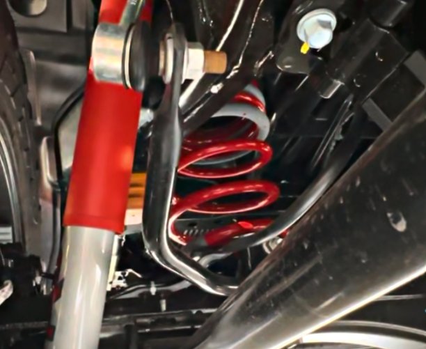

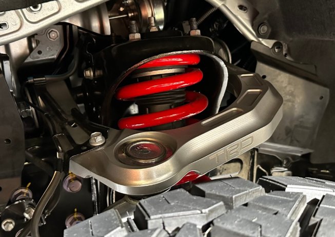

    Dealer info about parts breaking seems suspect. The Bilstein shocks are probably the same design as the OR but slightly taller (and with a red vs blue boot), the red springs are probably the same as the Pro, and the upper control arms look like the Pros minus the red paint.
    Interesting that Toyota's description says the upper control arms are steel and made by Roush. Pretty sure Roush only makes parts for Ford and the uppers on my Pro are aluminum not steel. Description doesn't say it comes with rear springs or if they are red. I've seen pics of 2025 Tacomas on lots with silver TRD (aluminum) uppers so unless they did a mid-production parts change you can't trust dealer or manufacturer info about this lift.

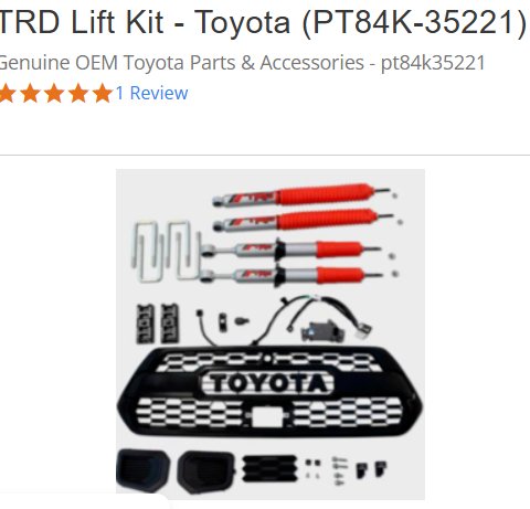

    The 3G Factory TRD Lift didn't include springs or upper control arms and the shocks weren't remote reservoir. But you did get a grille.

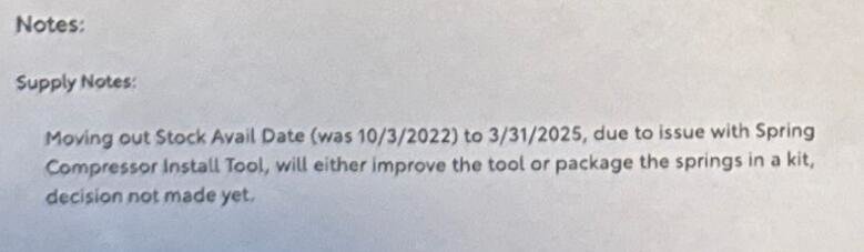

    I’m not saying that my local dealer is run by Warren Buffett, but I’m pretty sure they’re smart enough not to turn down a for-sure $3400 sale, for which they get the money immediately, just to try to sell me a $400 kit they have on hand already.
    There has been nention of this stop-sale in different threads on this forum and in other Tacoma forums for months. This is not new information and not unique to my dealer.
    Here’s what someone posted on a different forum that their dealer was able to look up regarding the stop sale. They blamed it on an installation tool that was breaking. That sounds familiar enough that I’m pretty sure I’ve read that in other places as well.
    I don’t claim to know every detail about this, but that kit is either impossible or very difficult to get right now. Hopefully not for much longer.

    What I find more interesting about the "factory" lift is that it includes new springs, shocks, and UCAs. Presumably because you need that combination of parts to properly do a lift. Aftermarket "lift" manufacturers will sell you a collar and say your stock shocks and UCAs are good to go.
