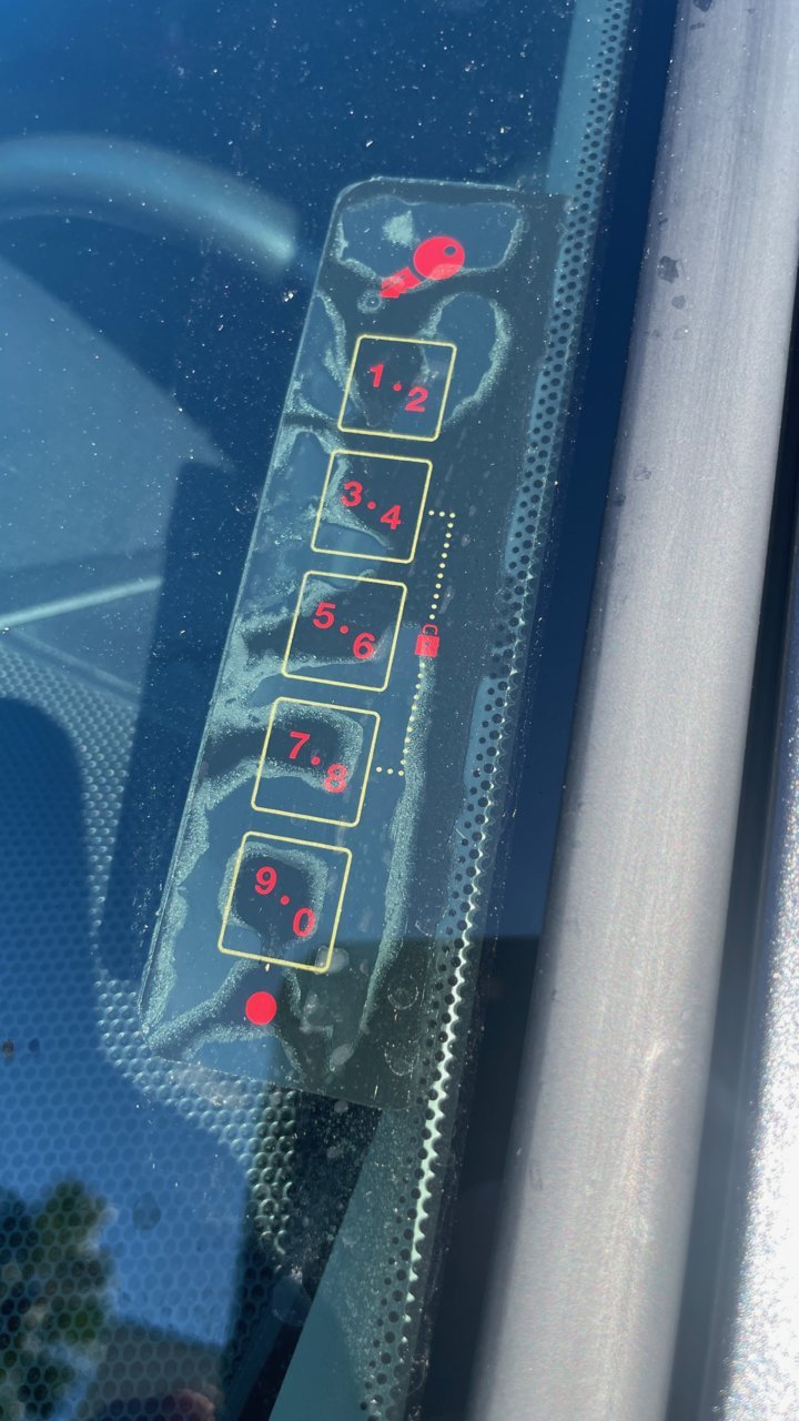

    I went to the dealer today to have this repaired and it turns out that my windshield had been replaced by the previous owner so that bubbling sticker is not covered under warranty. So, now I will try to replace that sticker which is supposed to be part number 00016-00506-BS but I can't find that part on any of the parts sites. I am going to try and replace the sticker portion myself if I can find where to get them.

    I've read before that it is a SET only option.
    It was said they will not sell it out of that district.
    Not sure if that helps but that's what I have heard

    It looks like you might be able to get a replacement keypad adhesive from ADDAUTOMOTIVE.com, you can check out what they have at least.

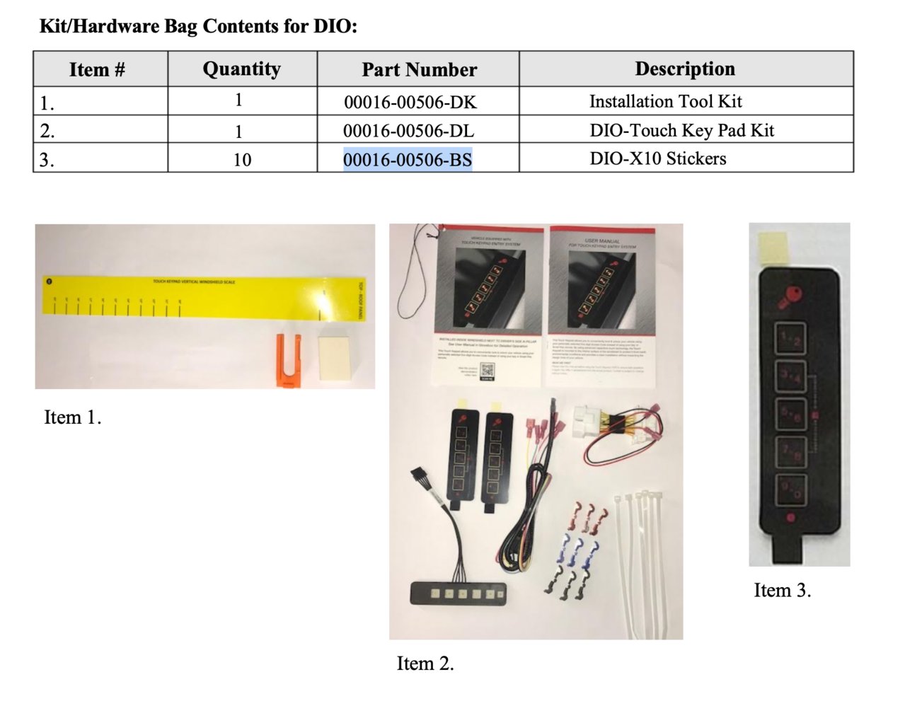

    It is a SET only item. Attached are the install instructions, and on page 6 you'll see the warranty info which states it's SET. Your dealer should be able to use the contact info on page 6 to get replacement parts. You'll also see the sticker and touch pad must be replaced together once the touchpad has been glued to the sticker which is why the warranty info page shows them with one part number. If the sticker was messed up before the touchpad was installed, it could be replaced separately (see page 17 of the instructions).
    Sparksparts sells the entire kit so you could try reaching out to them to see if they can help as folks on TW have generally been pleased when ordering from them.

    Thanks @Homiec ! I did contact Sparks Parts and they did sell me just the sticker part. I just installed it and reused the old keypad. Cleaned off all of the adhesive from the keypad and the windshield and it worked perfect! Thanks again for the idea!
