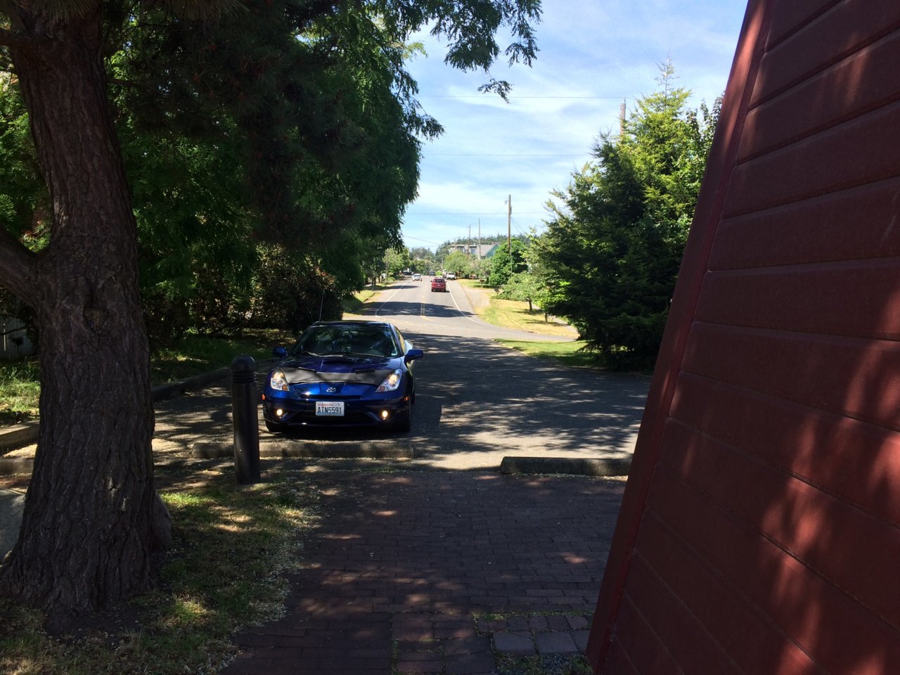

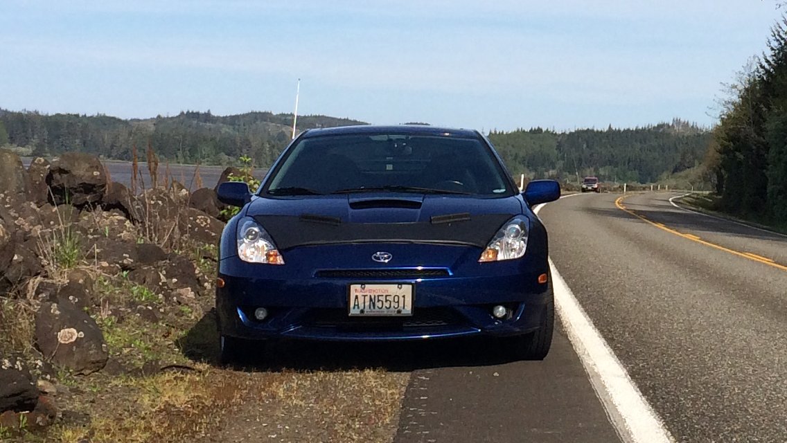

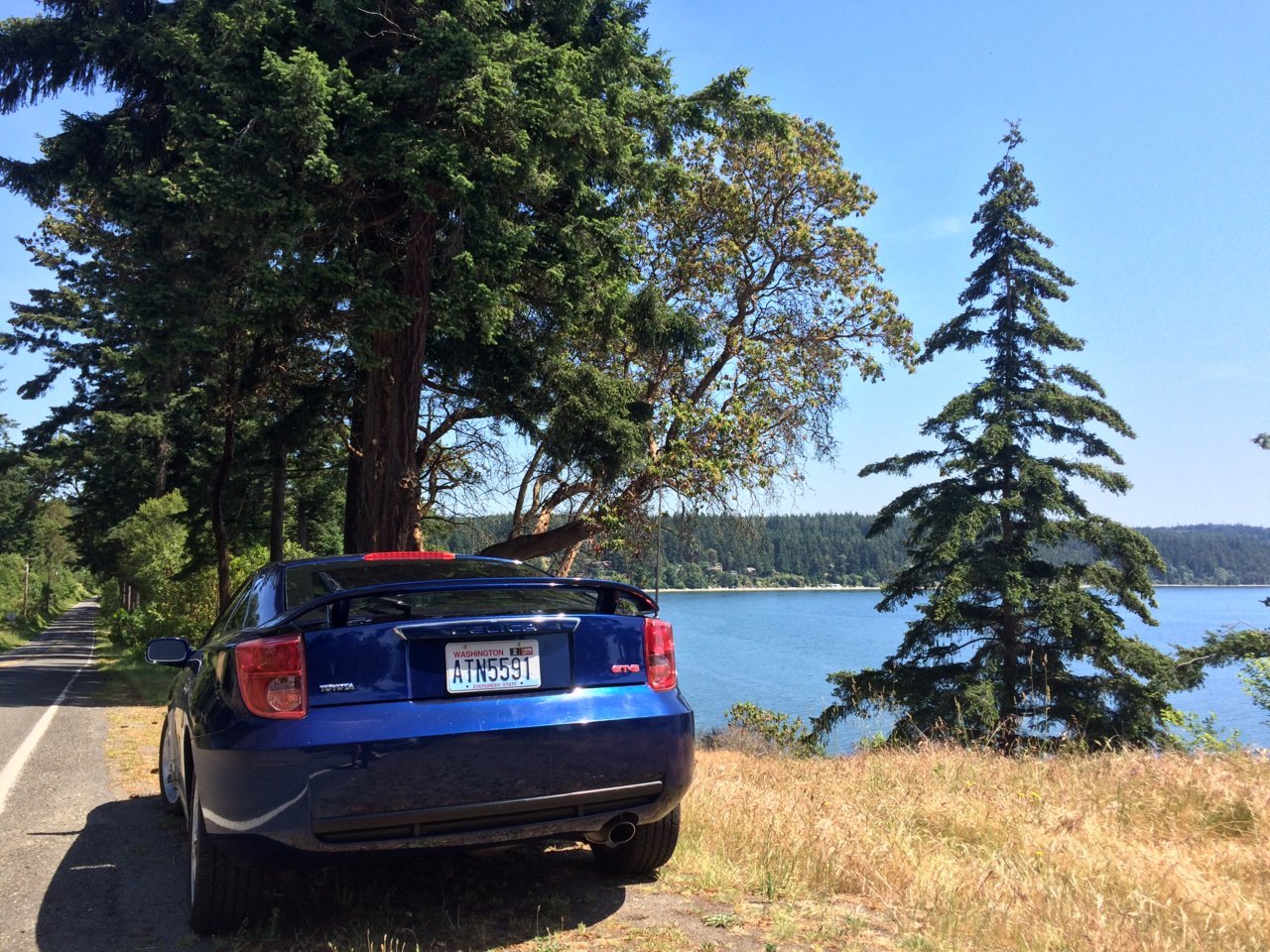

    Hey everyone! So before I bought the Tacoma and moved out to Virginia, I drove a 2003 Toyota Celica GT-S. I picked it up my freshman year of college with just over 80,000 miles on it. The engine and the transmission were perfect, the car was totally stock minus a bangin' sound system, but the little electronic things like the power door locks and dash lights weren't working. I fixed those issues, and the car got me through four years of commuting to college with basic maintenance. I moved away in 2018 and my parents held onto the car.
    Now I want to bring it out to where I live and make it nice, and do some tasteful mods. I never liked the riced-out Celica look at all. I'm more a fan of the OEM-plus look. I drive it around whenever I'm home, and it could use a little work. I got a good start last spring with the brakes. All new discs, new calipers up front, ceramic pads, pushed as much of the old fluid out and topped it off.
    1. The tires are about 5 years old but they still have decent tread. If they're dry rotted I'll look into replacing them.
    2. There's a whoom-whoom-whoom noise coming from the back of the car, it's really noticeable on smooth pavement. My mind goes straight to wheel bearing BUT I had the rear passenger wheel bearing done shortly after getting the car. Turns out it wasn't necessary, the noise at he time was coming from the shitty snow tires that came with the car and the mechanic kinda screwed me but I digress.
    3. The steering wheel shakes back and forth and the car pulls and gets kinda darty at highway speeds. I had the car aligned a year ago but the problem didn't go away.
    4. Bumps are pretty harsh. I think all the suspension components are original. I'm looking at Tein coilovers. I don't necessarily want to lower the car as much as I'm looking for a handling and ride quality advantage. If anyone has experience in this regard I'd greatly appreciate the input.
    5. Overall vibration and harshness seems high. Maybe I'm used to the nice and new Tacoma but trips on rough freeways are brutal. My first inclination is to sound mat the cabin, but are there bushings in the suspension and steering that get dry rotted and contribute to it?
    I know that's a lot. My question quickly turned into a journal of sorts. If anyone has any input of suggestions on anything, I'd greatly appreciate it! Once the maintenance and drivability stuff is taken care of, then comes appearance restoration and the mods. I love this car, we've been through a lot, and I want to bring it with me on my adventures out here on the east coast.
