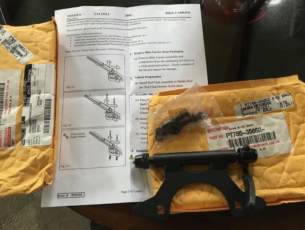

    Here’s what I was looking for. Discontinued part but I found one on eBay. Thanks for the tips.

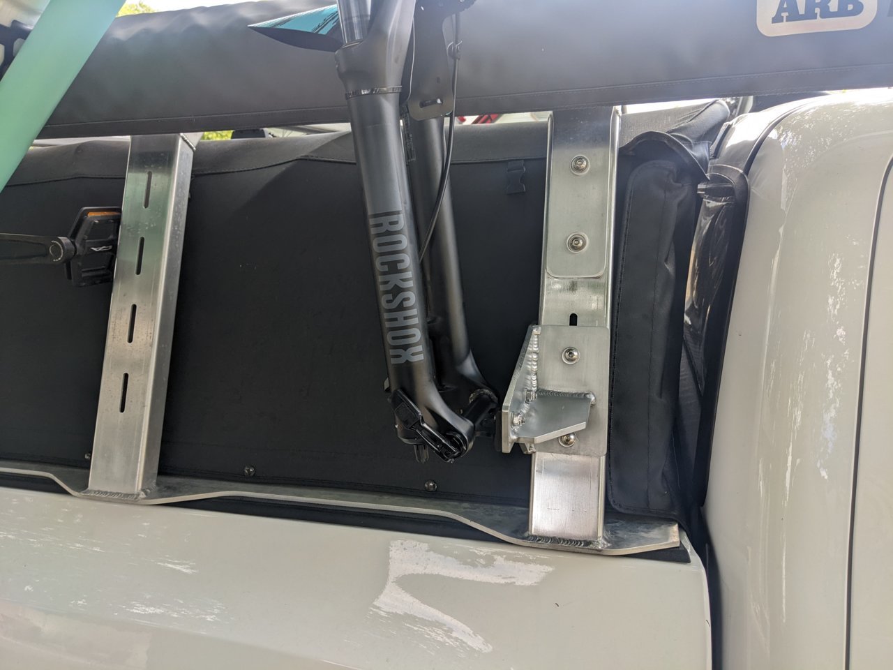

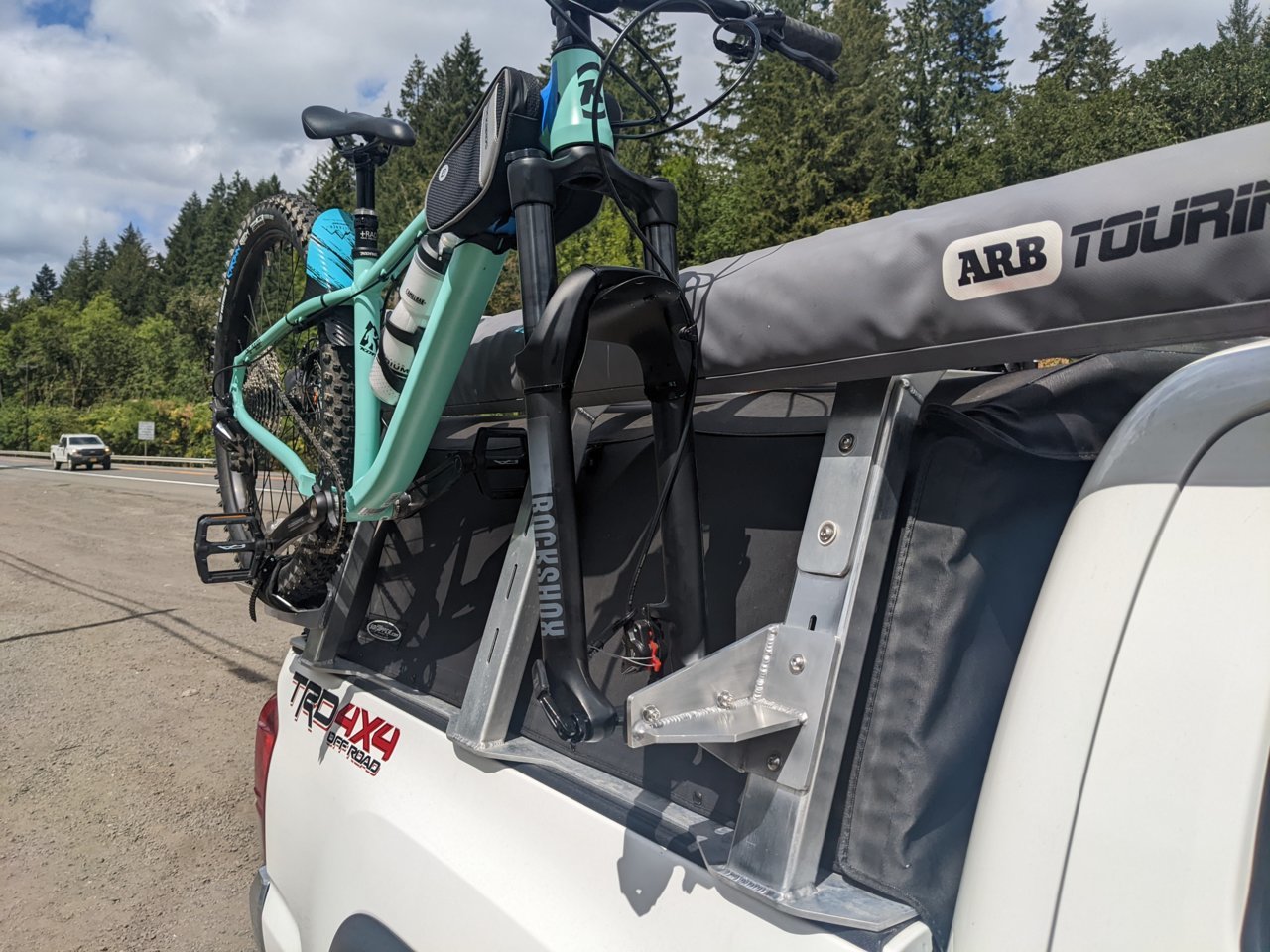

    Probably not directly what you were looking for, but might give you ideas for a custom mount.
    I just finished these up this morning and took it for a 10 mile spin up the road @50-60mph to check on wind noise (none), wobble, (none) and side view restriction (very very minimal if any).
    These will allow me to carry both MTBs now and tow my small off road trailer without a hitch mounted bike rack.
    My '22 Trek Roscoe 8
    Wifes '22 Kona Big Honzo
    Her bike is less than a 1/4" from the awning at both ends. However, it doesn't move.
    Rocky Mounts 15mm through axle perch mounts.
    I jacked the ratcheting straps off the boot bindings from a $29 snowboard that I picked up at my local Goodwill.

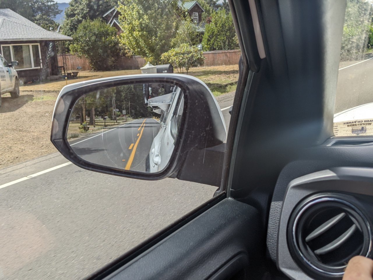

    Can see along side the truck just fine through the side mirror.
    If I loosen the handle bar clamps and clock them to be inline with the frame, I could load two Hobie kayaks in between the bikes. I honestly don't know when I would ever do that though, as my kayaks would certainly ride on my trailer if I went camping somewhere that has trails and water to play on.
