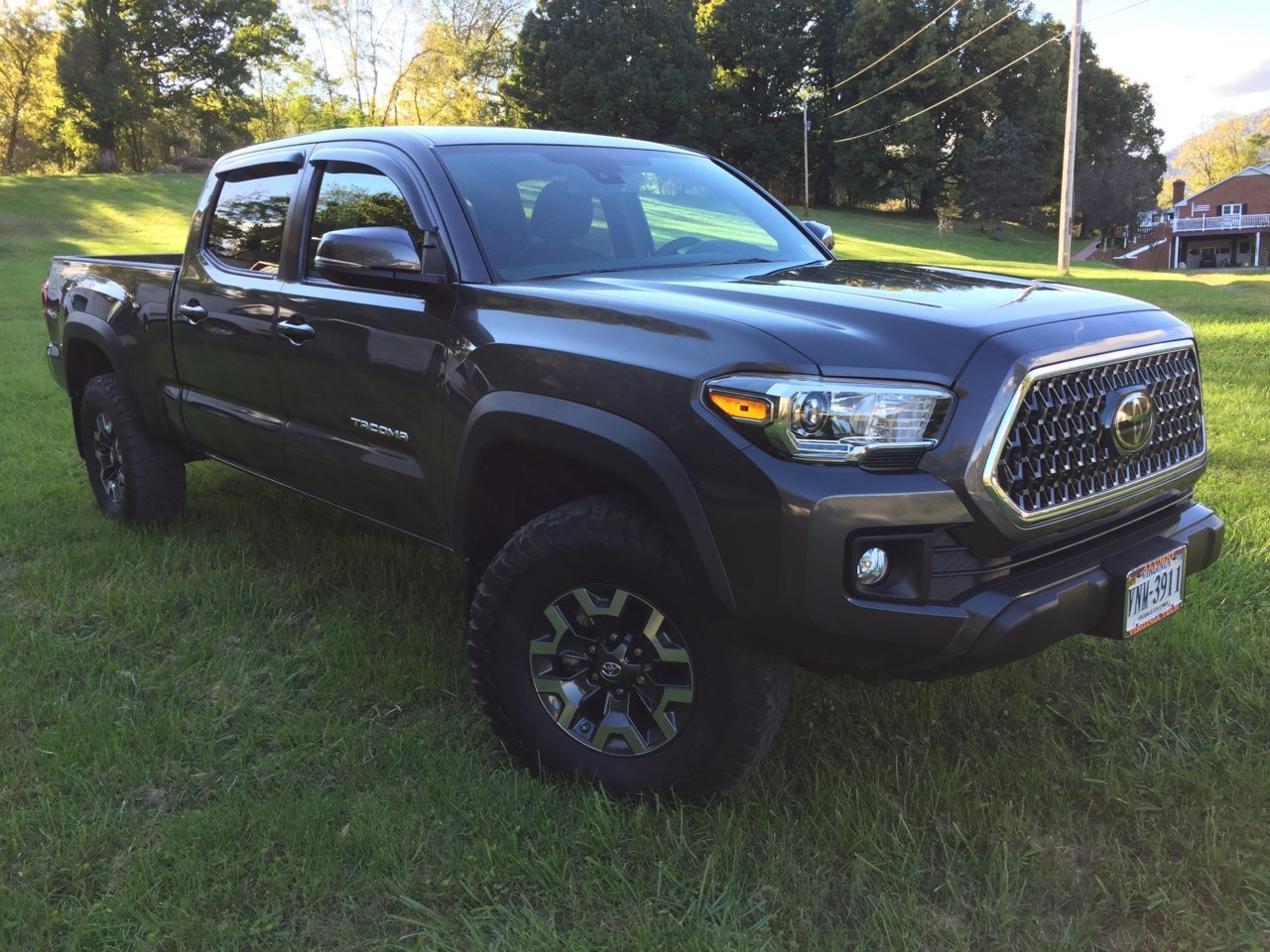

    I agree with @eccracer104, you'll be fine on this size. The part about the mud flaps being an issue, that depends on a lot of factors:
    * The brand of tire (some are slightly larger than others in the same size rating)
    * Caster settings on your truck (some have more positive caster, pushing the tire away from the cab mount)
    * Extra weight that you have on it (brush guard, aftermarket bumper, etc) that might pull the nose down.
    This is my girlfriend's 2013 TRD OffRoad, bone stock except for the 265/75R16 KO2s. No rubbing anywhere under full articulation.
    eccracer104 likes this.
