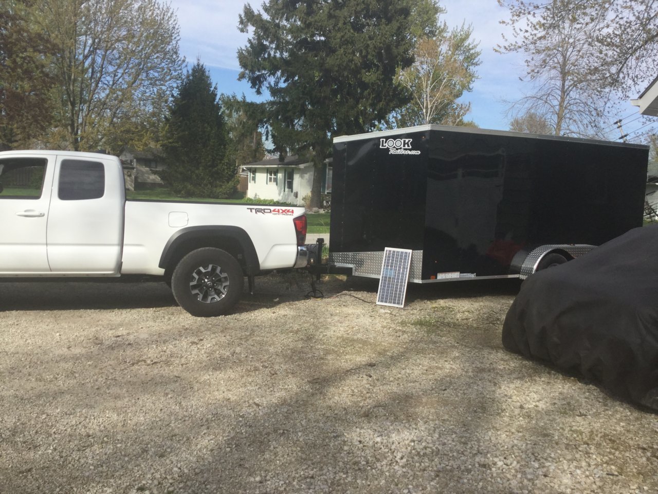

    Wondering if anyone has experience towing an enclosed trailer or rv with both a cap and without?
    I have a 14’ enclosed with the 2.5’ v-nose. I tow with an empty bed and have been contemplating building an aluminum rack and covering it with a thin aluminum skin similar to having a cap. I was wondering if this will have a benefit aerodynamically. Not looking for theories or opinions. Hoping someone has actual real world experience and can chime in and give definitive experience that the cap is a big help on fuel economy or it doesn’t have any substantial effect.
    I have lots of room in my enclosed / toy hauler / race bike hauler / rv and the bed of the truck. I don’t need more storage so this is strictly for aerodynamics / fuel economy. I don’t want to spend big bucks in something I find doesn’t solve my issues or build something that also just wastes time and money.
