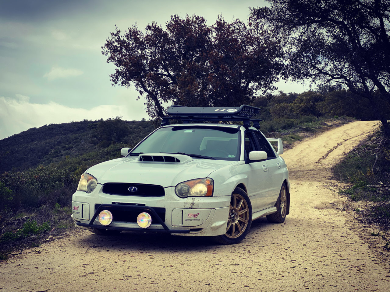

    Howdy. I am looking to get a trailer to tow my 2004 STI rally car around between rallyx events, my house, and the shop, and I need to figure out what kind of trailer to get into.
    I want something that isn’t wildly expensive, preferably just a flat trailer I can put the car on, as I will be carrying spare parts/wheels for the subie in the taco.
    I’ve never towed anything before so this is all new to me, but here are a few questions:
    What do other folks out there use to tow their toys around?
    Do I want a 2 wheel or 4 wheel trailer?
    How long of a trailer do I want?
    Can the taco even handle towing a car that weight?
    Any other tips/tricks would be helpful, or steer me in the direction of another thread if this information is out there already. Thanks!
    Pic for attention :hattip:

    I don't think the WRX would work with a dolly unless it is almost on the ground itself. There's barely any clearance under the WRX as shown in the photo.
