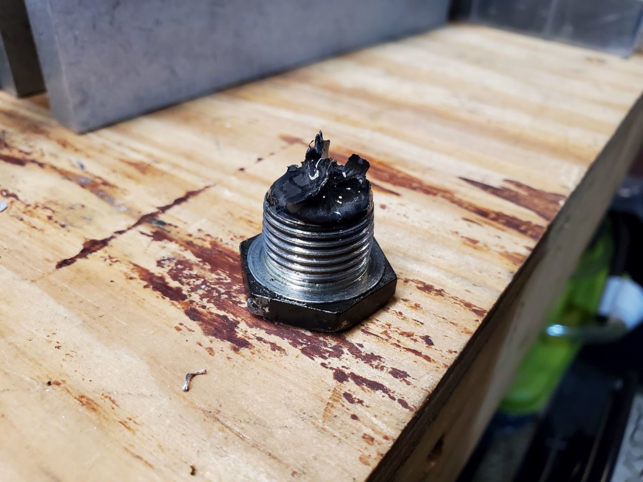

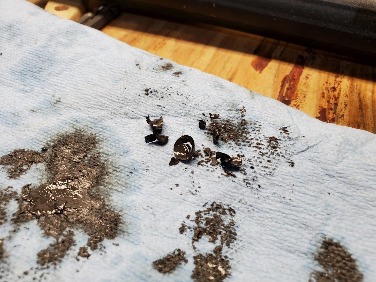

    Here's what I found on my diff drain plug magnet when I changed fluid the other day. I don't know that my problem is specifically towing related, but I tow about 1300lbs every weekend with lots of stop and go driving.

    Is that your first diff fluid change? That looks like manufacturing swerf not damage.

    Some of that looks as if It came from the Manufacturing/machining process and didn't get removed. Is this the first diff drain?
