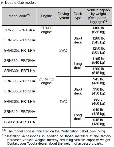

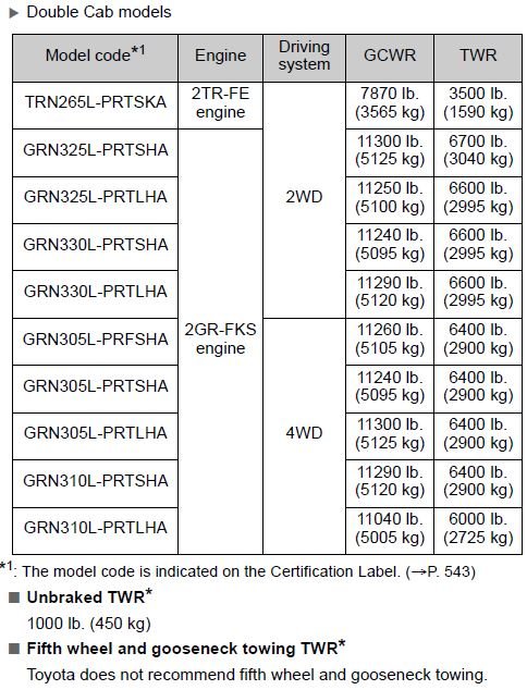

    Hi, I am trying to put together a chart of information so that when I go to purchase a trailer and or haul, I have the right information. I need to know how much weight I can haul on this truck safely. I am totally new to this and am looking for some sound advice.
    Truck info:
    2022 Tacoma SR5 w/ towing package, 6' bed, double cab, 4x4
    Engine: 2GR-FKS, GRN310L-PRTSHA
    Sticker on inner door states:
    GVWR: 5,600
    GAWR: 3,050 Front Axle, 3,280 Rear Axle
    Payload appears to be 940lbs in the manual.
    Information that I'm trying to sort out and clear up:
    1. What's the difference between TW and TWR?
    2. What would be the tongue weight?
    3. What is the max weight I can pull with and without trailer brakes?

    1. What's the difference between TW and TWR? Weigh Safe – as well as most experts agree – that an acceptable tongue weight for any trailer is somewhere between 9 to 15 percent of the gross trailer weight (GTW). Therefore, if you are towing a 5000 lbs trailer, the tongue weight should be measured at approximately 500 lbs.
    2. What would be the tongue weight? You can find this out on the trailer spec sheet. Usually, it is less than 1k lbs.
    3. What is the max weight I can pull with and without trailer brakes? If properly equipped, with a rated trailer hitch..It can tow a max weight of 6800lbs. But if you read the experiences of others on this site, that weight is not a very safe weight to pull with your Tacoma.

    I know you didn't ask specifically, but if you're thinking about the max you can pull you should also be thinking about trailer brakes any time you approach that number. I'm running a little larger tire (285) and that alone reduces my braking capacity, so when I pull anything 'heavy' I want trailer brakes. I also fully recognize that "Tacoma" is not the first truck to come to mind when someone says they need to pull something.

    If you are thinking of towing heavy you really have the wrong truck. These are more "handy duty" than heavy duty trucks, a utility trailer, pop up or micro light works fine.
    Trailer brakes are required in most states over 3000 pounds and you definitely want them even under that weight if they are on the trailer. As you move up in weight a weight distributing hitch makes a large improvement in the overall towing experience.
    The real issue these trucks run into is the lack of payload. Payload includes trailer tongue weight, anything in the bed and anything in the cab -- people and dogs included.
    A quick bit of math:
    940 payload
    -300 subtract you and a passenger
    =640 payload remaining
    -500 subtract 10% tongue weight of a 5000 pound trailer
    =140 payload remaining
    The above is with a showroom stock truck - nothing in the truck bed, no first aid or recovery gear, no mods, no tools, bikes, lawn chairs. You see how quickly you run out of payload, there just isn't much to work with.

    The yellow and white door jamb sticker will tell you what your specific truck's payload is. The more options you got with the truck the lower the payload rating will be. Your truck will safely/comfortably tow around 5000lbs max. It can legally tow more but it won't be as safe or comfortable as a lighter trailer.

    My sticker, unless I didn't look at the right one does not have the payload. I will look in the AM again.

    The truck likes 3500 lb. The truck hates 6500 lb. Set tongue weight at 10%. I have towed all weights. I know what it likes.

    I highlighted the part of the sticker that shows your actual payload.
