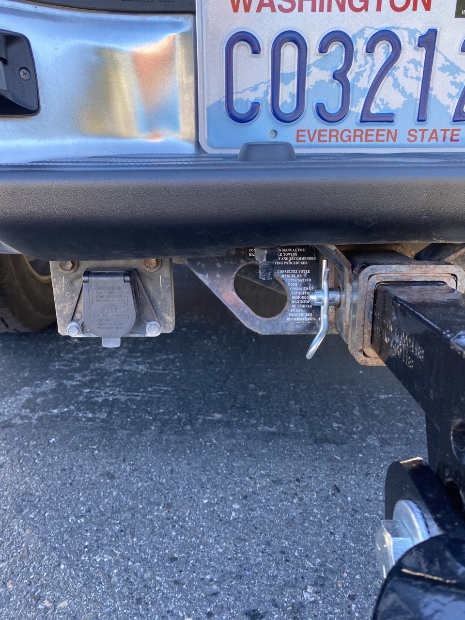

    • 029337F9-E286-4DFD-BF99-7A15747DC362.jpg 7ED782E1-8D57-494B-8EF5-E3149CDC6AC1.jpg FE4F444A-5BC5-45F5-8AE3-889235DE6781.jpg 2DB6D447-5763-41AA-96FE-BE1FDD39C7A1.jpg Thanks, Zaitsev77 For the input and welcome. I was afraid of that. Wtjl240, a tech at the toyota dealer thought one if the lines in the photo was for a trans cooler. Not sure where to look for a pink fan, but I found something that’s pink. :)

    Looks like you have the tow package. That was the pink fan I was referring to. The transmission cooler will be a small rectangle in front of your radiator
    edit: also what does the sticker say on your hitch receiver? My 2018 doesn’t say anything but my f150 has a sticker that says what it’s rated for. I can’t remember if the 2nd gens have a sticker that says anything or not

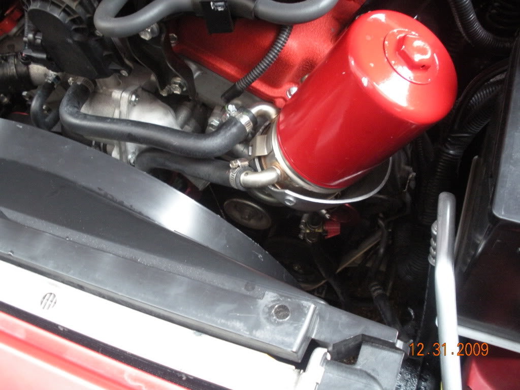

    Well I hate to keep playing devil's advocate, but I have a pink fan hub from the factory. You can see it in the background below along with my oil cooler in the foreground.
    That said, your hitch AND 7-pin look like OEM. There are so many aftermarket options for 7-pin plugs that are way cheaper than OEM and work exactly the same, so if all the things you've shown so far, that's the most confirming thing to me that you have the tow package.
    Also, most people would never put the OEM transmission cooler on since there are MUCH better aftermarket options, so if you can post a picture of the front of your radiator behind your grille, that would pretty much guarantee you have the tow package from the factory.

    Wtjl240, thanks for all this help! I do have the rectangle in front of radiator and I believe my brake controller is plugged into a pigtail. The brake controller wires are the red, white, and blue ones to the right. There is no tow rating on my hitch receiver...it just says to check owner’s manual. So I see everything is pointing to a tow package so can all this be added after factory? Is there any ‘updating’ done on a VIN#?

    Everything looks factory to me. If someone went through all the trouble to add all that then they spent some $$$ doing it.
    One other thing you could check is run your VIN through decodethis.com. Sometimes it'll show the tow capacity, sometimes it won't (and it may show 3,500 lbs, I wouldn't worry about it). However, after looking at everything you've posted, I'd say you have the factory tow package and would be fine to tow over 3,500 lbs.
