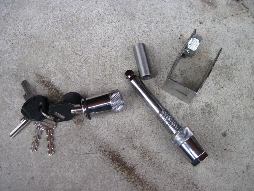

    They make anti-rattle devices that slip over the ball mount and have either spring or screw tensioner.

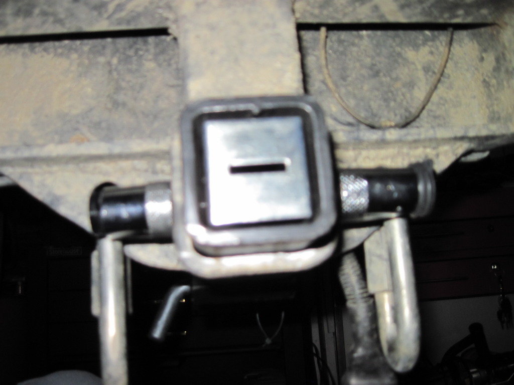

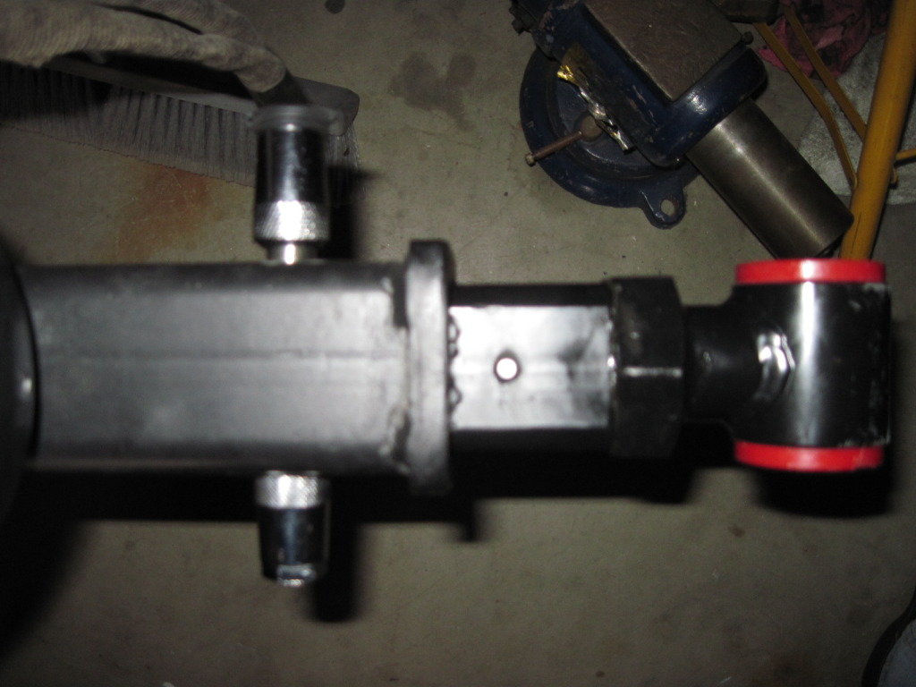

    I use the Tri-max anti-rattle hitch pin/lock.
    Two of them actually.
    nothing rattles... evar
    I recommend a little blue locktite on the threads
    just so's it can't loosen.
    good choice...
    if running a receiver/ball mount.
    But it won't work if using a solid bar ball mount.
    crappy pictures... I know
