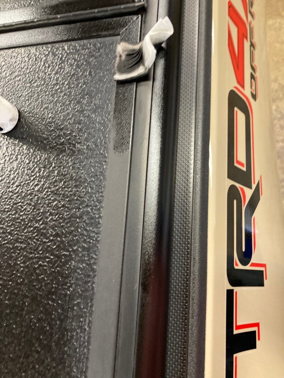

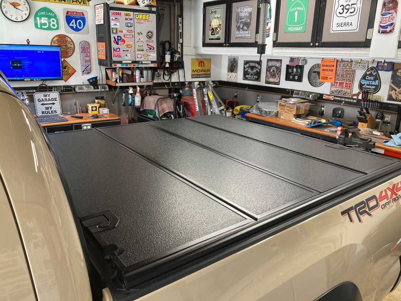

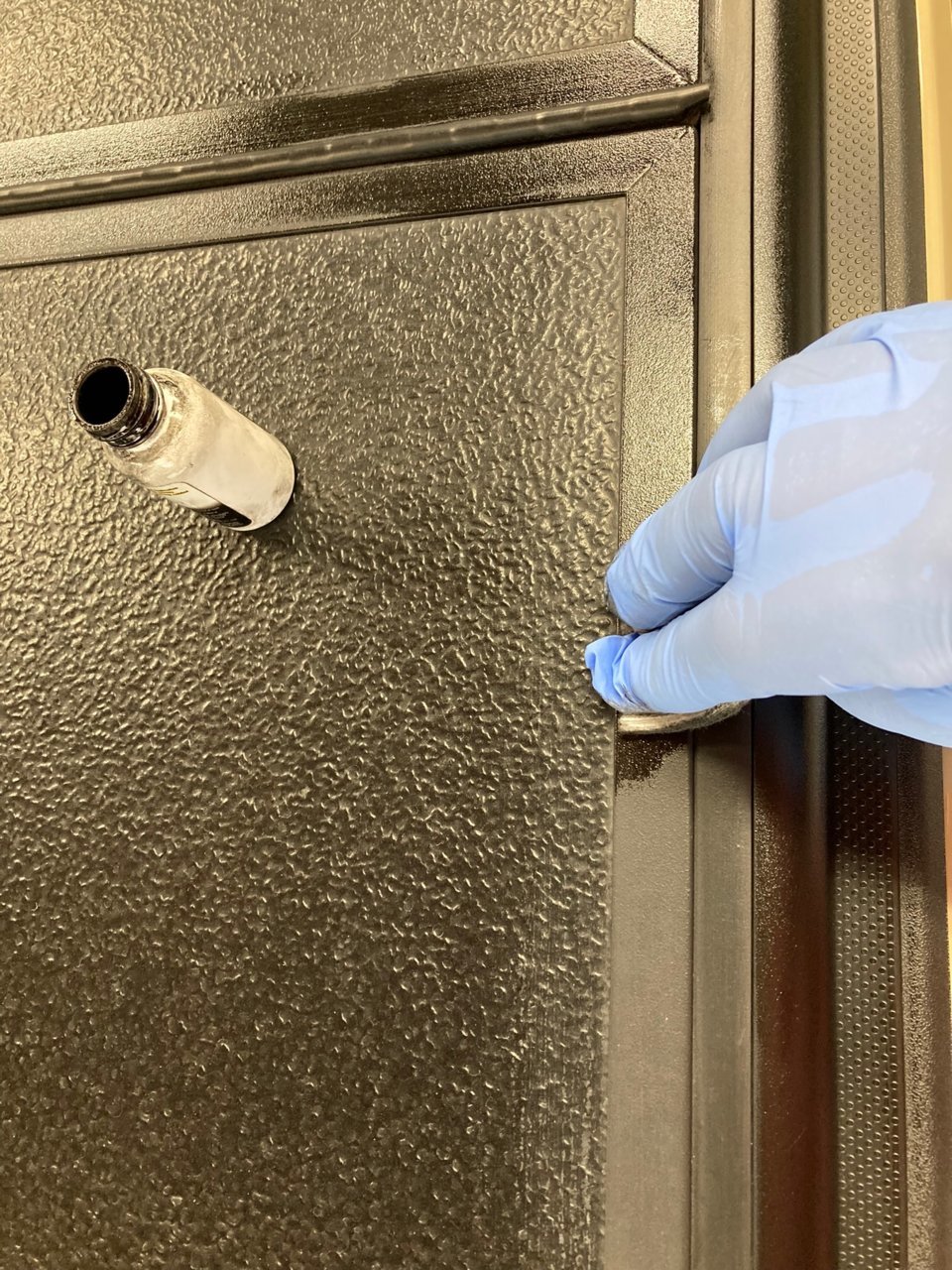

    Some of my black plastic trim on my tonneau eau was looking a little oxidized. I remembered I had some trim restorer my son gave me which came from one of his suppliers as samples. Tried it out last weekend and I am pretty impressed so far. We’ll see how it wears over time. It did a great job on my tonneau, but did an even better job on my wife’s JK top. This product came from Solution Finish. It’s an ounce or so of product, but it goes a really long way. This stuff looks like India Ink, and reminds me of when I was a draftsman working in ink on Mylar. It seems to work well and that small bottle did my small area on my tonneau and the JK’s entire top, plus the mirrors and door handles. The JK had a lot of oxidation on top and anything I ever used only brought it back moderately. This stuff brought it to a deep black. It looks better than new. I pressure washed, then soap cleaned everything I treated. Then it was all wiped down with rubbing alcohol as per manufacturer’s instructions. I applied it with a small pad working it in thoroughly, let it sit, and wiped any excess.
    This stuff can be a little messy, So gloves are a must and it should be applied from the top down or center out so you don’t drag any clothing across it.

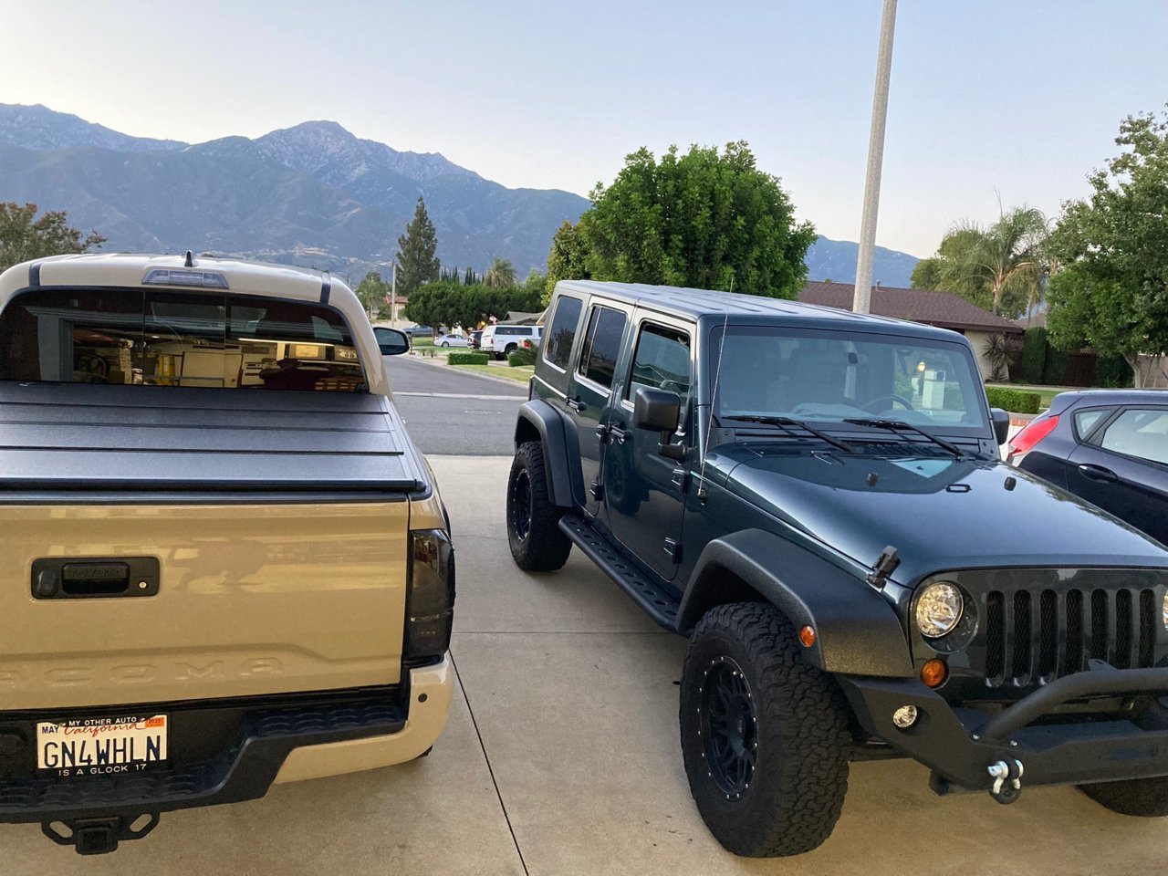

    Good to know, I think I’ll try that next time. The roof on my wife’s JK is hard to keep looking good. The plastic on my OR seems to be holding up well so far, the Jeep top seems to be more prone to oxidation.

    If it is plastic, bed liner does not adhere well to it. From my understanding, it has to be encapsulated to keep from peeling. If you look at the Jeep in the first post, I had the (plastic) fenders line-x sprayed. They are encapsulated. They look really good and I have had no problems with them. They stay shiny black and clean up easily. Jeep should have made the fenders like this.
