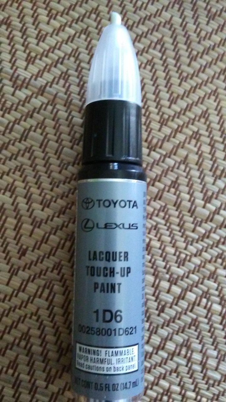

    Thanks Charles, that may be something I will look in to later. I used the EOM Toyota 1D6 paint from the dealership. The truck is only four months old and the touch up paint was from a fresh, new bottle. I know a guy who does good body work, I may check with him later. I guess these silvers and metallics can be hard to match.

    Well, I went to the dealership and went over the issue with the parts manager. They were very nice about it. He even gave me a 2nd bottle of touch up to try and I tested a small section, the color was just like the previous bottle (crap!) They gave me a refund, but really what I wanted was a solution.
    He pointed out that the touch up is lacquer and different from the base paint at the factory, etc. I get it.
    He also said that they have had several vehicles this color 1D6, that have been different shades from the factory, even without considering the touch up paint differences.
    I have had paint work done on my Avalon in the past and the entire front bumper had to be painted, and all the body shops say when a bumper is painted it may not match 100%.
    One day if I find a solution I will come and post here, but for now I'm leaving it like it is. Not worth it for a few scratches down low, and with my luck I would have the entire bumper done and get in an accident on the way home...
